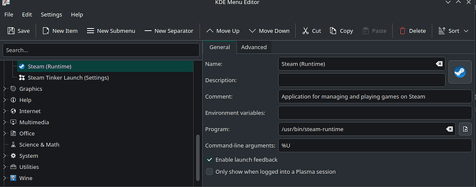

i have a report from user in Stable about Steam
on launch this happened , something missing ?
GDBus.Error:org.gtk.GDBUS.UnmappedGError.Quark._g_2dexec_2derror_2derror_2dquark.Code8:
l'exécution du processus fils /urs/bin/Steam-runtime as échoué
if started from desk xfce there this error
from launcher exe no error

The shortcut changed the name from steam-runtime to just steam.
i had to rename it from here
