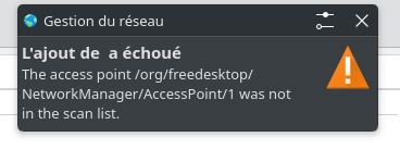

For me, this update pop problem. My wifi, who woked great before now disconnect/connect each ~30 seconde or minute.
The icon of the wifi let is place to the ethernet while the wifi crash.
I had the problem fisrt on my true install, let it slide and do a restaur with timeshift
Then i had the (bad) idea to do a fresh install to start on new ground. The live iso don’t show me problem and so, i proceed the install.
But the freshly new install OS up to date give me the same problem.
The thing is, when i don’t login to my graphical session but use the TTY, i have all the wifi in the world. And so i think something who start in the gui make that wificard lose is mind but i’m not techsavy enought to know where begin to start searching. I know NetworkManager as been updated maybe i should look other there?
Ps: I have reinstall Manjaro on that hardware to find what is the problem, it can break while trying to debug it, i really don’t care.

Yes i have try with the 6.18 kernel on my original installation. (and on another laptop who as the same problem, i tryed the 6.19rc1 and the 5.4)
If you have, then it might not be a simple case of using a different kernel, so the extra information is critical, so please do. My day is ending here, but the information would be necessary for anybody trying to be of assistance.
If that can help there is (a part of) the output of :
journalctl -u NetworkManager.service –no-pager

When i go to recreate it (in the KDE main menu in the network tab) a error was displayed (the 3 or 4 try before i was able to connect at my wifi):
The addind as failed (<<i translate that part)
The access point /org/freedesktop/NetworkManager/AccessPoint/1 Was not in the scan list.
