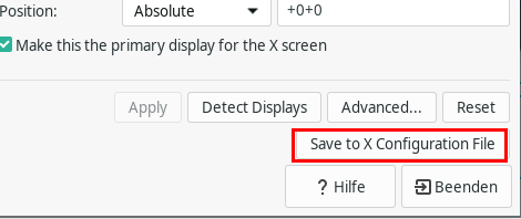

“Apply” means it is set just temporary for this session. If you want to set the settings permanently then you need to overwrite the xorg.conf.
Auswahl_231
Yes, I have done so. I’ve saved that file there using nvidia-settings and verified that the contents of that file look sane and match my intended setup. The contents of that file are present in my first post, in the cat /etc/X11/xorg.conf output.

  • An example of fixed layout for multiple monitors would be like this (this is my config, please don’t use it except as example):

Once you modified make sure you run this:
sudo mhwd-gpu --setmod nvidia --setxorg /etc/X11/mhwd.d/nvidia.conf

I have copied /etc/X11/xorg.conf to /etc/X11/mhwd.d/nvidia.conf and run sudo mhwd-gpu --setmod nvidia --setxorg /etc/X11/mhwd.d/nvidia.conf. I’ll try that for now, and go fishing for the iGPU toggle setting in the BIOS, then report the result.
