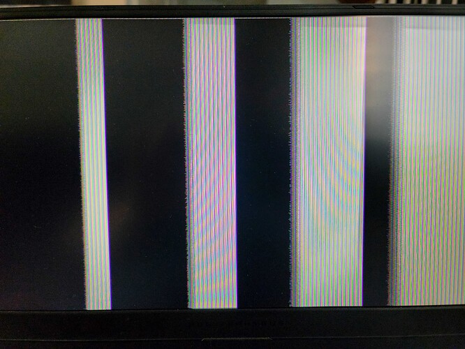

This is on a laptop that has an AMD iGPU and an Nvidia dGPU (2060 Max Q).
I can install Manjaro no problem. Reboot and everything works fine. The moment I run an update and the kernel + graphics driver gets updated I get the following screen corruption.
The strange part is this actually happens with other distros too. The corruption happens right after UEFI logo.

The strange part is that previously booting into the older kernel used to work, but now it doesn’t and causes the same corruption. I’m almost positive it’s a driver issue between the AMD iGPU and Nvidia dGPU. The corruption happens immediately after selecting which kernel to boot.
Booting into command line mode only also has the corruption.

Just did a fresh install with the latest media available. Haven’t run an update yet. Next step will be updating to see if I still get the corruption. One positive thing is that this is already running a later kernel version.

Fresh install seems to have worked. Latest media is @ kernel 6.9 (previous was 6.7). Looks like whatever bug this is/was caused by going from older kernel to newer one. Here’s hoping it’s fully resolved
