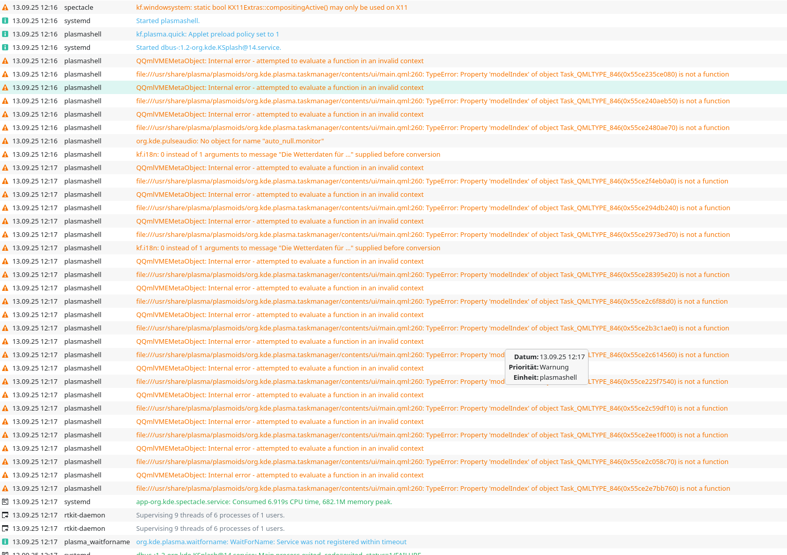

Plasmashell crashing every 5 minutes
My install is fresh after a ssd died. It ran fine initially, now the panel disappears every 5-10 minutes and i have to restart plasmashell.
I run manjaro unstable, no plasmoids/widgets, not even a wallpaper.
Just 3 displays, 3 panels, very few apps (firefox, obsidian, spectacle, dolphin)
I disabled audio because i suspected a connection but it still crashes.
I also suspected the weather plugin because if shows up in the log so i removed it, but it still seems to be running in the background, i don’t know if this is normal.
I also use the proprietary nvidia drivers and while i don’t suspect them right now, they have caused issues in the past.
I just checked the nvidia-forum after the recent disaster with gtk apps freezing and could not find any issues about plasmashell crashing.

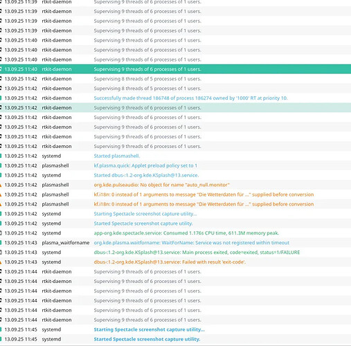

I think it’s caused by spectacle, because while conversing with you i have not used it and it didn’t crash since 20 minutes.
Now i made a couple of screenshots and once it crashed and several times it distorted / stretched the panel.
