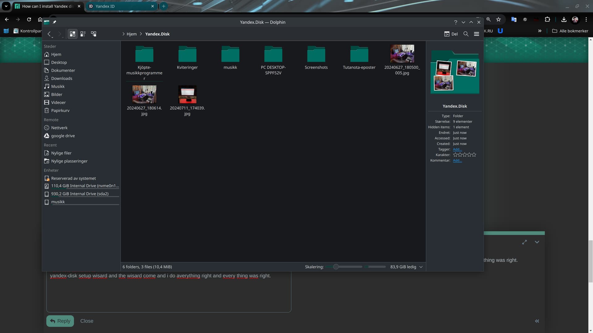

I use this comand in terminal
yandex-disk setup wisard and the wisard come and i do averything right and every thing was right.

I have done it. But there are quite a few of them so I stuck to one of the first. But I think people need a summary and in the right order, so I’m posting this:
Open Console/Terminal and paste in the following:
pamac build yandex-cloud-bin
pamac build yandex-disk
3.
When the installation is ready, enter the following in Console/Terminal:
yandex-disk setup
4.
Just follow the description that appears in the Console/Terminal
If you are asked to enter a phone number when the website appears, click on more options. You must log in to your Yandex disk and then copy in the code that you received in Console/Terminal.
Then you go back to the Console/Terminal and answer a question.
That's all. You should then have created new directories in your file manager.
Am have try this instruktion tre times now and its perfekt.
