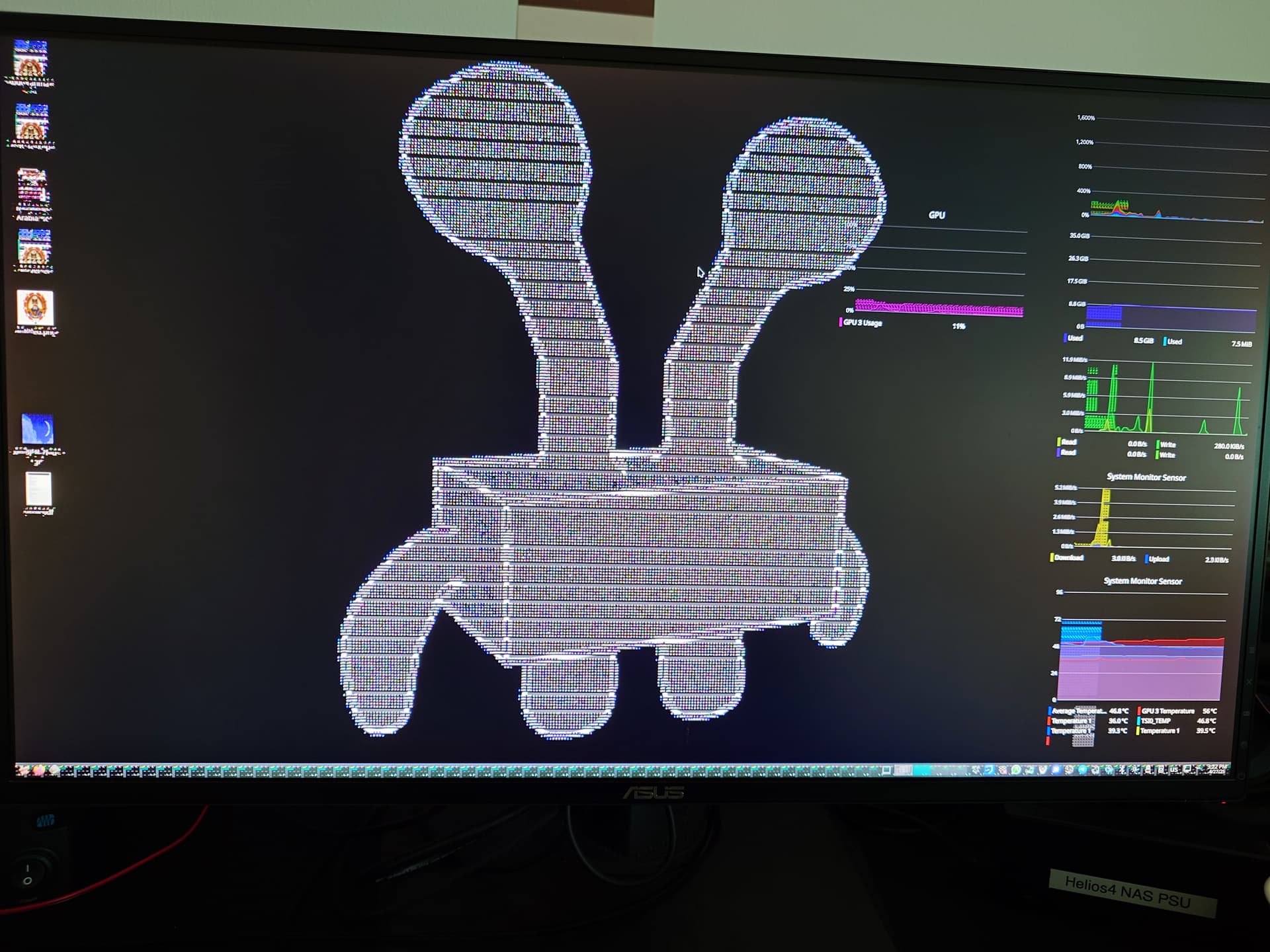

Now it seems that it’s better than before, but I’m still getting issues. After waking up from suspend, I first get a black screen, but the mouse cursor is movable. After 10-20 seconds (sometimes more), I get the screen unlock screen. When I type my password, the text field is sometimes responsive, but sometimes it randomly freezes for a few seconds before resuming.
After unlocking the desktop, any windows I had open are usable, although there’s still some random freezing. The plasma panel is frozen and unusable. I can open programs via the terminal, which I can start with Ctrl-Alt-T. Any notification dialogs that plasma wanted to display also get frozen. I’d like to emphasize that there’s always some random freezing (the mouse stops moving, desktop is completely unresponsive) for a few seconds before the desktop becomes responsive again.
The only workaround I found is to log out and log in, which results in a perfectly usable desktop. A reboot also works, of course. But these workarounds defeat the purpose of suspend/resume.

Well I’ve tried out Wayland. It does seem to resume better… At least it doesn’t getting random freezes.
However on my second try to resume, I got some strange graphical bugs. The desktop is perfectly usable however. Here’s a picture.
I was under the impression that the systemd services is supposed to prevent these from happening. Perhaps they haven’t been configured correctly?
I have looked into this section in the Arch wiki
https://wiki.archlinux.org/title/NVIDIA/Tips_and_tricks#Preserve_video_memory_after_suspend
I made sure that:
  • PreserveVideoMemoryAllocations = 1 in /proc/driver/nvidia/params
  • TemporaryFilePath = /var/tmp
So preserving video memory should be working, but the graphical corruption indicates to me that it isn’t.

Well, after reading a couple of threads online, I tried adding this line to /etc/modprobe.d/nvidia-power-management.conf
options nvidia NVreg_PreserveVideoMemoryAllocations=1 NVreg_TemporaryFilePath=/var/tmp
and then rebooted. In wayland session, it seems to have solved my graphical corruption issue, after suspending twice. I need to suspend more times to be sure, but I think that solved my problem!
It’s strange though, because based on /proc/driver/nvidia/params I thought those two options were enabled… but I did it anyway because it seemed to work for people.
EDIT: following up on this, I have been suspending and resuming perfectly fine on Wayland without any trouble. I must’ve done it like 6 or 7 times already with 0 issues. I also tried switching to X11 and doing the same thing, but the issues persisted. So it must be something to do with X11 and how the nvidia driver works with it. Switching to Wayland must’ve fixed everything. Thank you @Mirdarthos for the suggestion to switch to Wayland!
EDIT2: NOPE! the graphical corruption still occurs!!! Unmarking this as a solution. Will still use wayland though
