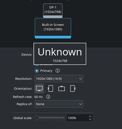

I spoke too soon? Not sure if this is an issue caused by update or a separate bug. I have an external HDMI screen that suddenly isn’t being recognized correctly (not showing proper resolution and missing a legit name… (it may have been triggered by connecting the HDMI at some random point in the boot sequence and triggered some edgecase bug?)
I tried removing configs like .local/share/kscreen/ and .config/kwinoutputconfig.json and rebooted in order to reset the display configs, and that didn’t work.
