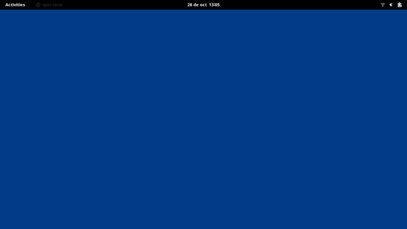

Lower resolution (960x540) on video-hybrid-intel-nvidia-390xx-bumblebee
I cannot post screenshot, I’m without permiss to do that.
That’s the situation.
Before I was able to boot with autologin. Now I activate it and I cannot enter in plasma.
Some message about KWallet did appears, and I reboot and since that, I only see this.
i see, i have no idea what that is…
