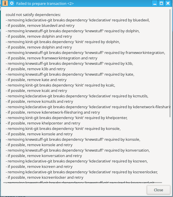

Kate don't start after last update
It doesn’t work, sorry
What is strange, I have no issue on the other devices… kio are not the same…
I would like to remove kio-git but it will be brake a lot of software… I mean it uninstall a lot of software…
My x86 64 computer with kio
An other x86 64 computer with kio
Install kio and it will ask you to replace kio-git with kio.
But you need to do this for each -git package you have installed.
Hi, OK I try
it doesn’t work… strange issue
during my update every software are close, I think it’s better
As I said, you need to do it for all the -git packages in the same go.
Try with pacman instead of Pamac.
If I remove kio git kio

Add kdeclarative kinit knewstuff to the pacman line and say yes to all.
Is it correct ?
sudo pacman -S kio kdeclarative kinit knewstuff

Add ksysguard libksysguard too.
You see the idea yet? :slight_smile:
Thanks a lot
something like that ?
sudo pacman -S kio kdeclarative kinit knewstuff ksysguard libksysguard
Yeah, and keep adding packages it complains about.

Again, add plasma-systemmonitor
You should really be able to see a pattern here you know.
I removed plasma-system monitor right now…
I installed this software in the past, but not on the other x86 64 devices, it explain why I have no issue on the other devices with kate !

The boot don’t pass the login and password, it’s frozen, it is not a joke, I’m not lucky with plasma system monitor
Don’t worry, I have my UEFI usb stick with Manjaro :slight_smile:
The problem is solve, don’t install plasma-system monitor !
Thanks a lot for your help all you guys

I had the same issue. The problem was indeed related to the *-git versions of some packages. First I restored a timeshift snap from before the update. In my case, I think I installed them to try the System monitor in February, replacing the original packages. To replace all of them:
  1. With expac I checked when I installed the plasma-systemmonitor-git package
expac --timefmt='%Y-%m-%d %T' '%l\t%n' |  grep plasma-systemmonitor-git
  1. Removed the package (replace yay for sudo pacman if necessary):
yay -R plasma-systemmonitor-git
  1. Used this date to replace all the packages installed in that day, change date accordingly and run first without the yes | bit to be sure:
yes | yay -S plasma-systemmonitor $(expac --timefmt='%Y-%m-%d %T' '%l\t%n' | sort | grep "2021-02-09" | grep git | cut -d " " -f2 | trim | cut -d " " -f2 | cut -d- -f1 | xargs)
  • trim being (save somewhere in PATH and chmod +x it, tried to add the source but wouldn’t let me post a link??):
#!/bin/bash
awk '{$1=$1};1'
  1. Update as usual
Hope it works, cheers!
