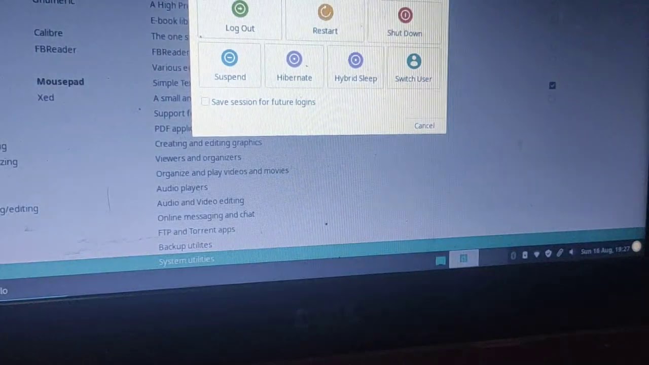

I’m new to Manjaro, and 1 years of Debian based distros. So, everything is somehow a little problem to me. I want to turn off beep sound which emerge whenever I click logout icon or some error occurr. Setting system volume to 0 doesn’t work for this. My DE is xFce. No problem with KDE Plasma used 1 week ago. Just switched xFce due to its simplicity.
Here is YouTube link!
