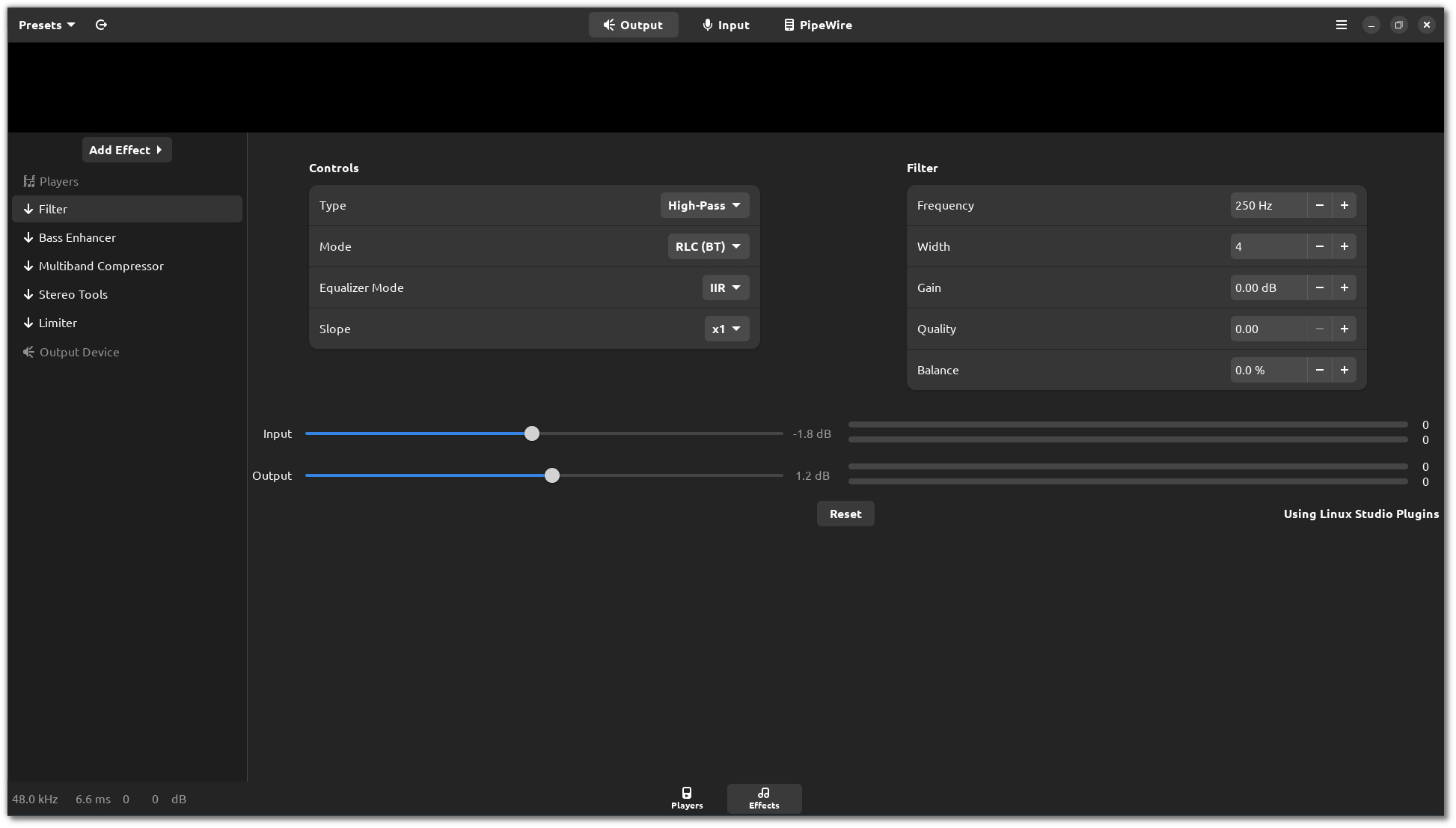

Step 5: Enable and configure Filter.
Note: Shortly after making this tutorial, the Filter tab layout changed. Follow which ever is installed on your system.
or
*Remember, set you Frequency to no lower than what your speakers can handle. If you can find the specs on your speakers, you will find the frequency response range, something like 175-20K or something like that. That means setting your frequency below 175 is pointless and can actually damage your speakers.
First of all we should remove frequencies that cannot be heard because even if the speakers are unable to reproduce them a lot of energy will be wasted in the process. This will lead to problems like not being able to use the full dynamic range and the introduction of digital and physical distortions.
Enable the Filter on the list and set the type to 36 dB High Pass (this will cut off everything below a frequency and will let everything above it pass) and the frequency to 50 Hz (which is definitely below your laptop’s speakers abilities). Continuously raise the frequency by 10 Hz until you start hearing a change in the lower end of the audible signal, which should be around 130-160 Hz. Subtract 10% (or 15 Hz) and set it as the Filters frequency. On my machine it is 145 Hz, since the signal started being affected at 160 Hz.
What happened is that we removed everything the speakers can’t reproduce at all, leaving a little bit of signal just below this frequency, which is quite important for the next step.

The Filter section changed, can you please update that?
I really don’t know how to do it on my own.
Also, with certain songs I have some electricity sound, is there anything I can do about that?
+1 on the filter section changing. A few versions ago they ported the filter effect from Calf Studio Gear to Linux Studio Plugins and added/changed some settings in the Filter effect - see changelog at 7.0.8. Documentation hasn’t been updated to match though and I’m still fresh to this, so will have to play around. If I come up with anything I’ll update this thread. Otherwise if someone else could share some knowledge that’d be really helpful

Could you update your tutorial, please? I couldn’t follow your instructions for setting up Filter, since I see the content above. Thanks.

It’s on my list of “to do” meantime, change “type” to High-Pass.
I have updated the “Filter” section to reflect the changes in Easyeffect, the rest of the tutorial seems unaffected.
