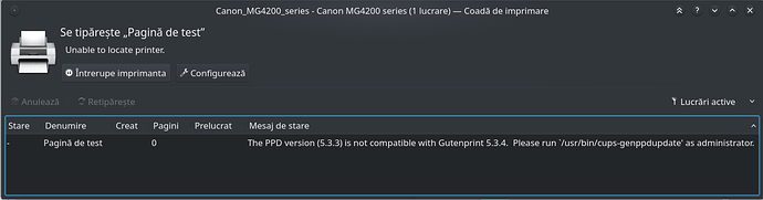

Printing the test page results in this message:
“The PPD version (5.3.3) is not compatible with Gutenprint 5.3.4. Please run `/usr/bin/cups-genppdupdate’ as administrator.”

Thanks for the help. I installed that AUR package and updated the PPD file, rebooted and now I get this:
Unable to locate printer.
