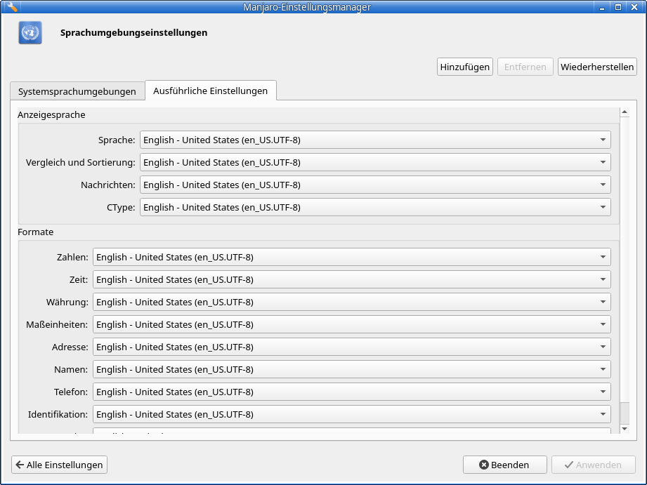

The irony is the following screenshot (after changing everything to en-US.UTF-8 and reboot) - everything looks as set to US-English but the system language is German…
That look strange - I give you that.
