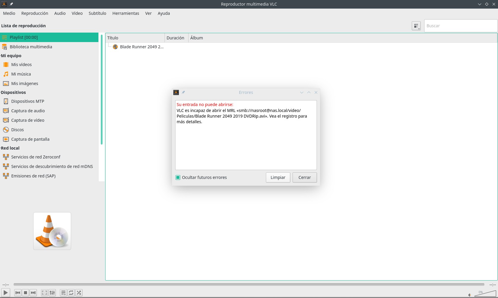

Hello. Thanks for answering.
What I mean by what Garuda does and Manjaro doesn’t, is because I want Manjaro to do it just as easy and uncomplicated. In Garuda I just run Dolphin, I scan my network to get to the NAS and I double click on the desired video and it starts playing with VLC without any problems. This is also achieved from the VLC itself. With Manjaro I only get an error message concerning the SMB that I still don’t know how to solve. To tell the truth, I’m more interested in using Manjaro. I want to switch from Windows 10 to this system, but first I’m trying to get everything that interests me to work. The VLC error message is the following, how do I solve it, what should I install?
I have Manjaro KDE installed.
I appreciate your kind responses.
PS: Ah, I already uninstalled the VLC and reinstalled it with all its suggested dependencies and nothing yet.
Do you have manjaro-settings-samba installed?
Installing kio-fuse works for me
Yes, I do
No change after installing ‘kio-fuse’ package.
Sorry,I don’t notice that it’s a DE related problem as you mentioned VLC / SMB - Watching videos via network-computer - #16 by A4orce84.
kio-fuse is from KDE framework,so it’s not working in Gnome.
