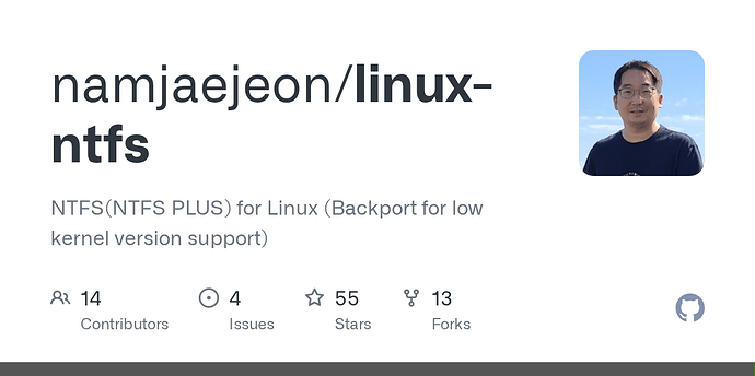

I think you mean this one :down_arrow:, which has been referred to as ntfsplus (but I think I remember seeing a reference to it being called ntfs).
Edit:
The link seems to refer to it as ntfs, but I’m sure I saw it elsewhere. Anyway it does seem to be called both ntfs and ntfsplus on the github page.
