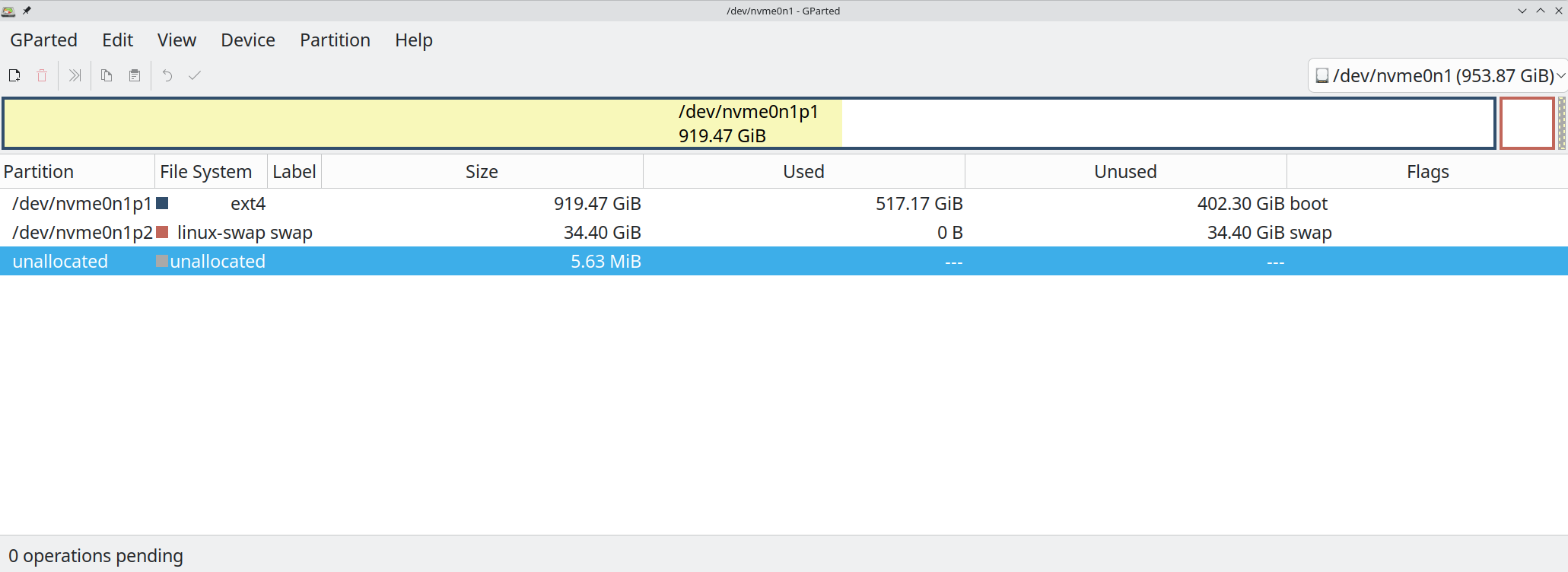

Just so you guys don’t take my word for it:
Anything else I could check?
Can you please provide system information as described (below) - even if its only from a Manjaro Installer live environment terminal.
From your pasted image it seems your system is installed as Legacy rather than UEFI; unless, of course, if the $ESP happens to be on a separate disk. Otherwise, it gives no useful information.
What was the result of doing as @Aragorn suggested?

Usually, I would see a “vmlinuz” image populate. The /dev/sdb1 drive is not a linux device (is running windows) so that output can be ignored.
Here is the requested system information running from a live environment:

This system is in UEFI mode currently. I’ve made it a habit of booting USB’s in non-UEFI mode for various reasons. I’ve rebooted the USB into UEFI successfully.
That EFI partition is attached to my Windows 11 disk. Yes - I have two windows disks (/dev/sdb is an old windows 10 system that I have been lazy to decommission). I can boot onto both systems just fine, and I did run an fsck on it

I must be blind, but I’m not sure how you guys can see the ESP from the gparted screenshot. That screenshot is of the drive where manjaro lives.

I saw the esp in the inxi (100 mb fat can only be esp), for the record. For the rest we have to wait someone else to give new ideas.
Translating the inxi
  • The first disk nvme0n1 a mounted partition ext4 (ID-1) and unmounted swap partition (ID-1)
  • The second disk nvme1n1 appears to contain a Windows installation (ID-2…5)
  • The third disk sda contains a single ntfs partition (ID-6)
  • The fourth disk sdb is a live ISO (ID-7,8)
Your efi partition is the Windows efi - which is located on /dev/nvme1n1p1
