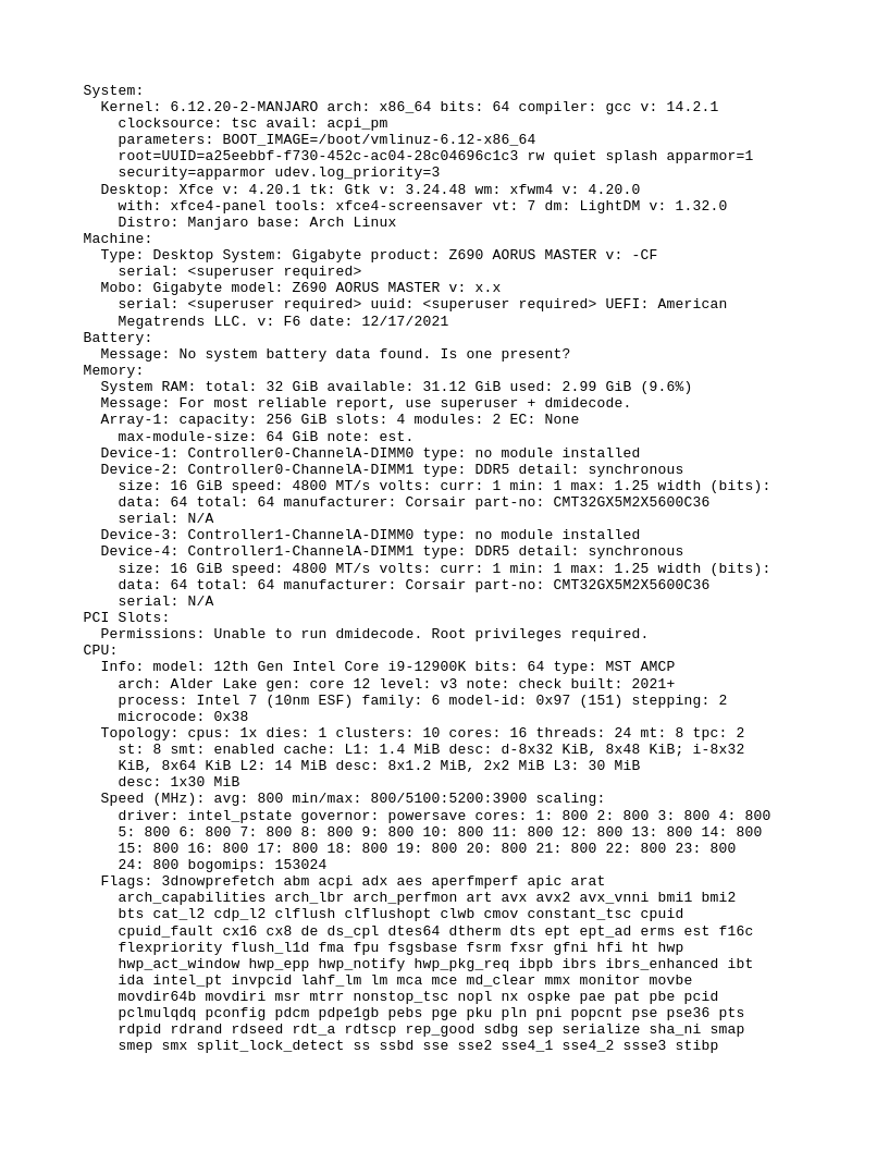

inxi -zv8 gives me this line in it’s output:
Desktop: Xfce v: 4.20.1 tk: Gtk v: 3.24.48 wm: xfwm4 v: 4.20.0

terminal invocation likewise. same inxi output as you. system is up to date.

Sorry, I posted the system info to
I started that thread to disconnect the pamac-manager bug from my gimp issues.
