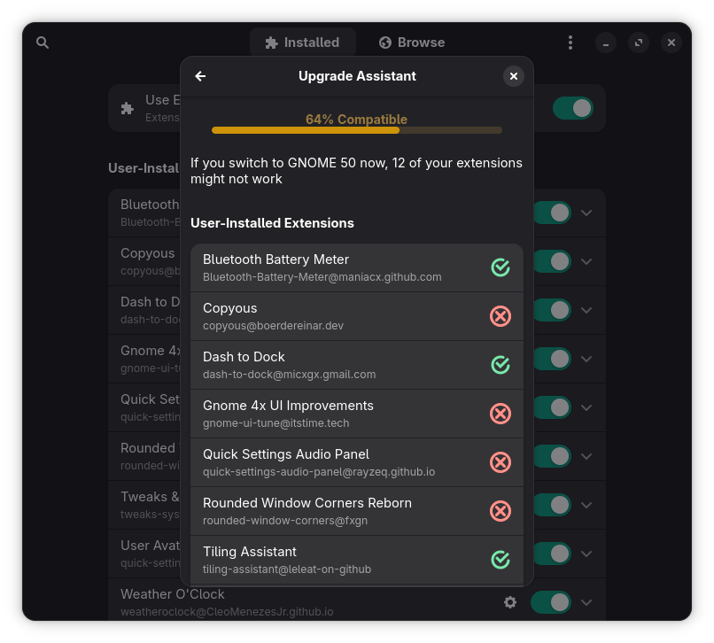

Totally forgot about Gnome 50 :
I love to wait till more expensions are compatible :wink:
There doesn’t appear to be any changes preventing extensions compatible with 49 to work with 50. Most likely just adding 50 to the metadata.json will be enough. See Port Extensions to GNOME Shell 50 | GNOME JavaScript
Waiting for Gnome 50 – Patience is needed. :innocent:

Unfortunately, it may also be a wait for extensions that are already updated due to a delay in the review process:
Keep in mind that only applies to local extensions, not system extensions.

Gnome 50 ist still in Gnome-unstable on arch, so I assume additional backlog also applies to the general gnome release (or just waiting for Ubuntu 26.04? :slight_smile: )
