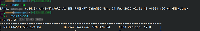

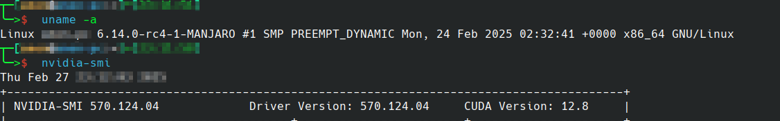

There is a new nvidia stable driver
Arch Linux - nvidia 570.86.16-7 (x86_64) Flagged out-of-date on 2025-02-27
many fix coming
Arch Linux - nvidia 570.124.04-2 (x86_64)
Repository: Extra-Testing
Signature Date: 2025-02-27 19:25 UTC
Last Updated: 2025-02-27 19:28 UTC
