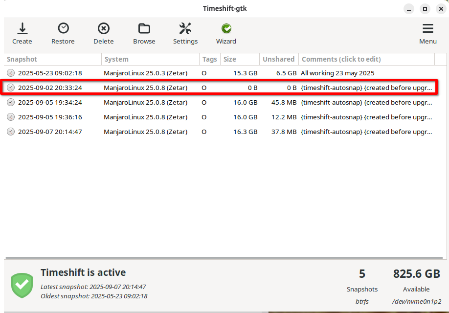

…and between “Deleting subvolume” and “Deleted subvolume” the command sits there a long time (sometimes 30 seconds, sometimes minutes).
The snapshot is, I think, this one:
Deleting it from the GUI does work (sometimes, but it’s somehow recreated (with different time stamps) at the next update (made with pacman -Syu or yay -Syu).
Does somebody know what it could be or how to debug it further?

This looks similar to a problem reported elsewhere related to btrfs quotas. I have never used quotas, but if you have them enabled maybe you need to do something with them to prevent this issue.
Yep, it seems related:
> sudo btrfs qgroup show . | grep stale | wc -l
179
…now (well, tomorrow) I have to find a way to:
  1. See how I can check if I have enabled quota (I didn’t, not willingly at least), and
    solved: the command is btrfs qgroups show . and if it shows qgroups then quota is enabled, otherwise it says ERROR: can't list qgroups: quotas not enabled
  2. disable (and clean) the whole thing keeping timeshift working.
    solved the command is sudo btrfs quota disable .
For now, it seems that
sudo btrfs qgroup clear-stale .
at least worked to remove the 179 stale qgoups (whatever they are :wink: )
Thanks!
An extra question: if I disable quotas, will timeshift continue working?
i disabled quota and it keeps working. still i also see rather some time between deletion of old snapshots 0 and 1
I did a test in a vm with manjaro unstable because unstable has updates.
First i deleted all snapshots with
sudo timeshift --delete
I noticed updates and the snapshot 0 and 1 were made and fast.
Timeshift does not need quotas in any way. :footprints:
There is a warning about quotas in the wiki
So, I am disabling the quota. What I did is:
Check that quotas are really enabled:
if you have a list, quotas are enabled. If you have stale qgroups, you can remove them with
That did not speed up the update process. So then I tried to disable the quotas:
check:
It seems that timeshift is still working, but now it doesn’t show the size of the snapshot:
> sudo timeshift --list
Mounted '/dev/nvme0n1p2' (subvolid=0) at '/run/timeshift/14460/backup'
btrfs: Quotas are not enabled
Device : /dev/nvme0n1p2
UUID   : 51a3a5b3-a6d6-456e-bbe3-935c914bd2fe
Path   : /run/timeshift/14460/backup
Mode   : BTRFS
Status : OK
5 snapshots, 824.3 GB free
Num     Name                 Tags  Description
0    >  2025-05-23_09-02-18  O     All working 23 may 2025
1    >  2025-09-05_19-36-16  O     {timeshift-autosnap} {created before upgrade}
2    >  2025-09-07_20-14-47  O     {timeshift-autosnap} {created before upgrade}
3    >  2025-09-09_19-27-26  O     {timeshift-autosnap} {created before upgrade}
4    >  2025-09-09_19-51-20  O     {timeshift-autosnap} {created before upgrade}
Then, as suggested by @andreas85, I removed all the timeshift snapshots:
> sudo timeshift --delete-all
…and added one new with the current status.
I will see if this works to remove the upgrade slowdown, and in that case, I’ll mark this post as the answer, hoping to help future users.
:partying_face::partying_face:EDIT:partying_face::partying_face:: I can confirm that now the updates are fast again :partying_face:. Also look at the following messages about “defragmenting” the volume…
