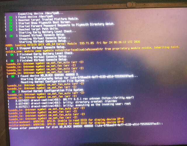

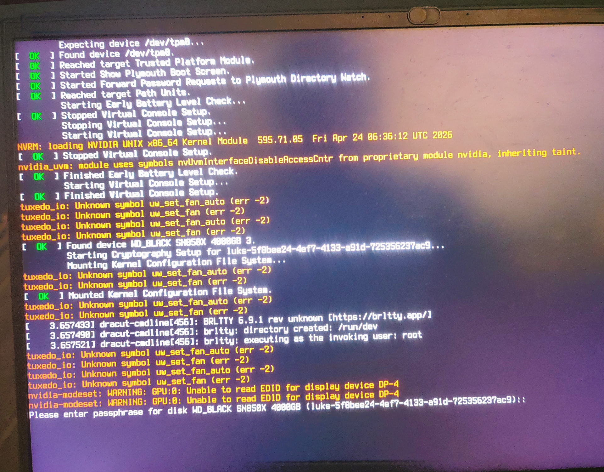

Temperature sensor/fan control not fully working
A recent update or config change seems to have broken a temperature sensor. The sensor “lmsensors/spd5118-i2c-2-50/temp1” cannot be read anymore, which means that I get an error in the task manager (where I’ve added that to a graph), “sensors” outputs this:
spd5118-i2c-19-50
Adapter: SMBus I801 adapter at efa0
ERROR: Can't get value of subfeature temp1_max_alarm: Can't read
… and Tuxedo control center can’t control the fan anymore and doesn’t display CPU and GPU temperature. Instead the profile from BIOS (“True performance mode” in “Insyde” BIOS) is used, but that’s usually either very loud, very warm or very slow.
I’ve tried sensors-detect, which found “Intel digital thermal sensor”, enabled lm_sensors.service and created /etc/conf.d/lm_sensors with the content HWMON_MODULES="coretemp", but I still get the same issues afterwards. I’ve also tried modprobe coretemp, systemctl start lm_sensors, reinstalling all Tuxedo stuff and some more things that I can’t find anymore. Fan control still isn’t working. I also created this issue report, but was sent here instead: Fan temperature unavailable (#367) · Issues · TUXEDO Computers / Development / Packages / tuxedo-drivers · GitLab
Output of some of the usual system info commands:

How can I get fan control working again?
Something seems off with your setup and not the code itself. Please open a ticket with support.
Did you do that?
Have you tried a different kernel like 6.18 or 7.0?
Oh, I missed the comment to contact the manufacturer. No, I haven’t yet, but I can do that now. (Edit: Done. Waiting for reply.)
I have not tried a different kernel yet, but it worked with this one before. I can quickly boot into 6.6 to test.
BTW, I’m getting some warnings during boot that might be relevant:
(I don’t know how to get that in text form, it seems to not be the regular system log, at least.)
Edit: Started running 6.6, now anything with spd5118 doesn’t appear at all in “sensors”! One error less, I guess? :smiley: But that’s not exactly helpful. The task manager still shows the same error and Tuxedo control center still can’t see the CPU/GPU temperature.
The “quiet” profile from BIOS seems to be risky, I think my laptop just shut down from overheating. So I guess I’ll go back to the one where the fan is always annoying.
After a lot of back and forth between the laptop manufacturer and the driver developer, I indirectly found the solution: I uninstalled all packages with “tuxedo” in their name, removed all of their traces from “dkms”, rebooted, installed “clevo-drivers-dkms-git” instead of the official Tuxedo driver and “tuxedo-control-center” from the “extra” repository (instead of the AUR version or the “…-bin” version) and rebooted again, then temperature sensing and fan+backlight control worked again in the Tuxedo control center. To also fix the KDE task manager, I had to then remove the GPU utilisation and temperature sensors and add new versions there.
