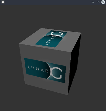

Maybe your card doesn’t support Vulkan and thats the reason the game fails to launch?,try installing vulkan-tools and do a test to see if vulkan is working properly,apply this command
pamac install vulkan-tools && vkcube
this install the vulkan tools and then execute a cube made in vulkan,if the cube displays properly then its working.

Intel mode runs VKCube smoothly, but has a rainbow-gradient instead of the texture in your screenshot.
Nvidia mode runs it with short but frequent hangs of the entire screen, same rainbow-gradient.
According to Nvidia, the 960m (Maxwell core) supports Vulcan. I also never had a problem running these games on Windows.
