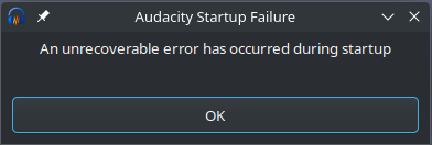

Audacity will no longer launch.
Launching by command line shows no errors, just a silent exit back to prompt.
After reinstalling it I get this error:
I have a job to do and Audacity is not going to get it done for me today, but I found this software that worked nicely to edit some audio files:
Ocenaudio
https://www.ocenaudio.com/
It is available to download from the AUR.
http://aur.archlinux.org/packages/ocenaudio-bin
