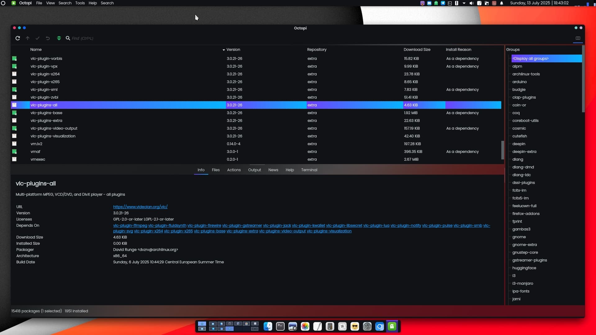

I only had a problem with vlc, but installing vlc-plugins-all everything works fine now

If you don’t have any Snaps or FlatPaks, then you can use octopi instead. It’s qt6-based, and it works directly as a front-end to pacman and — if required — an AUR helper.
