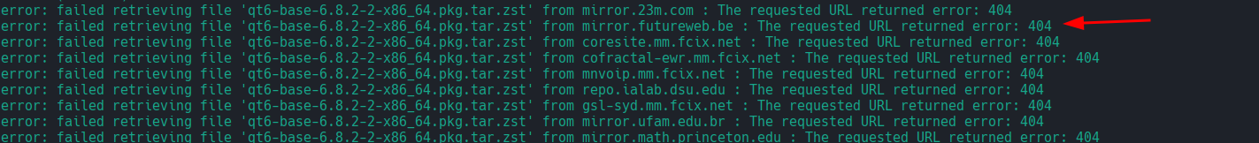

Then on my KDE Plasma one: failed retrieving file 'qt6-base-6.8.2-2-x86_64.pkg.tar.zst' tried a few different mirrors, but maybe it’s just a question of waiting for them to get updated.
(I have checked, for example, mirror.futureweb.be/manjaro, which is fully synced, but also doesn’t seem to have it)

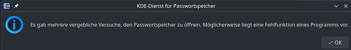

KWallet doesn’t open anymore.
