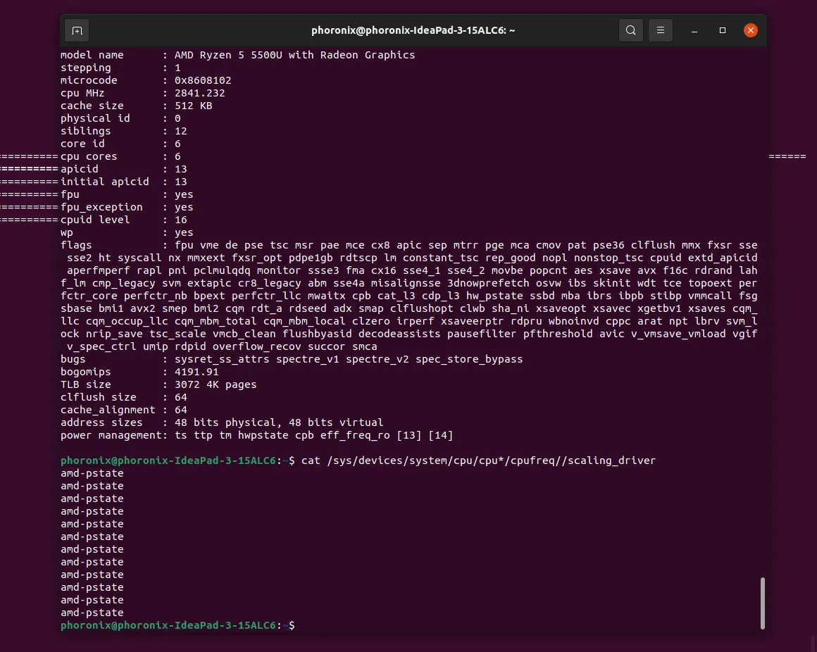

Anyone know / findout that we can use options amd-pstate replace=1 on 5.18.3?
So with these pending patches it would allow simply having amd_pstate.replace=1 as a kernel parameter to boot the system and use AMD P-State without blacklisting ACPI CPUFreq or rebuilding your kernel with this new driver built-in. This would also allow users to toss “options amd-pstate replace=1” into the /etc/modprobe.d directory on distributions like Ubuntu as another easy means of switching. Thus this convenient patch series is making things much simpler for the kernel builds out there having AMD P-State as a module and ultimately making it even easier for users to opt into using this new driver focused on better power efficiency.

There is no option amd_pstate.replace in the list of modinfo.
You can check what is the output of sudo modinfo -p amd_pstate that shows only one parameter/option.
shared_mem:enable amd-pstate on processors with shared memory solution (false = disabled (default), true = enabled) (bool)
That means the option replace does not exist in Linux Kernel 5.18.3
And the other option amd_pstate.enable does not exist too.
