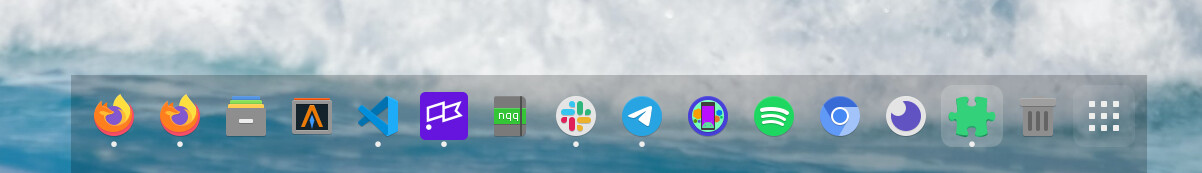

My dock is squared, transparent and tall(?) and before the update it was almost opaque, rounded and normal-sized. Not sure what happened there.
@johnnyasantoss Shell theme is broken in the latest update. Either downgrade it or switch to Adwaita.
they said you can delete it, you don’t need it
wow I thought I only had issues with steam but yeah my dock also changed.
are you also on kde plasma?

I’m using Gnome, but I think I’ll switch themes to see if it gets fixed
hello,
same problem here after an update of gnome-shell-extension Night Theme Switcher today.
All Extensions were turned off.
Not sure if this is a solution for you but I removed that empty folder:
(check if folder is empty before removing)
$ rm -rf $HOME/.local/share/gnome-shell/extension-updates
Then I just logged out and in again. (perhaps reboot might be helpful, too)
Starting the Extension App, I switched on extension again( in the upper right corner)
and I got my ā€˜old’ look n feel gnome-shell configuration back.
could you please come back to me once you switched themes? would be highly appreciated!!
