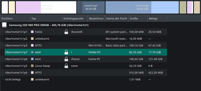

I’d also suggest creating a separate /home partition which will not only keep your user data physically isolated from the Linux system itself, but also allow a greater ease in managing your personal data in the event you ever need to reinstall the system.

Good Morning,
I would do it as @soundofthunder suggested.
I was helped very well here, in the forum to shrink my /root partition and create a separate /home.
Then I reinstalled Manjaro.
As @soundofthunder said:
Save the /home before and restore it later.
All my settings were carried over, everything was as before.
I did this on my notebook while the system was running.
/root partition I shrinkend it to create a new partition.
Content copied into it.
See [Move /home to another partition] (My thread for Move /home to another partition)
translated by Bing-com
Greetings
Tony

Morning all,
@ARSManiac I think what @soundofthunder said fits to me and I think even to you right now.
That is how I done it.
Free_Space_of_Root_Partition
So I installed with the minimal ISO and installed already some Programms. Still some space over for other Programms.
Greeting
Tony
