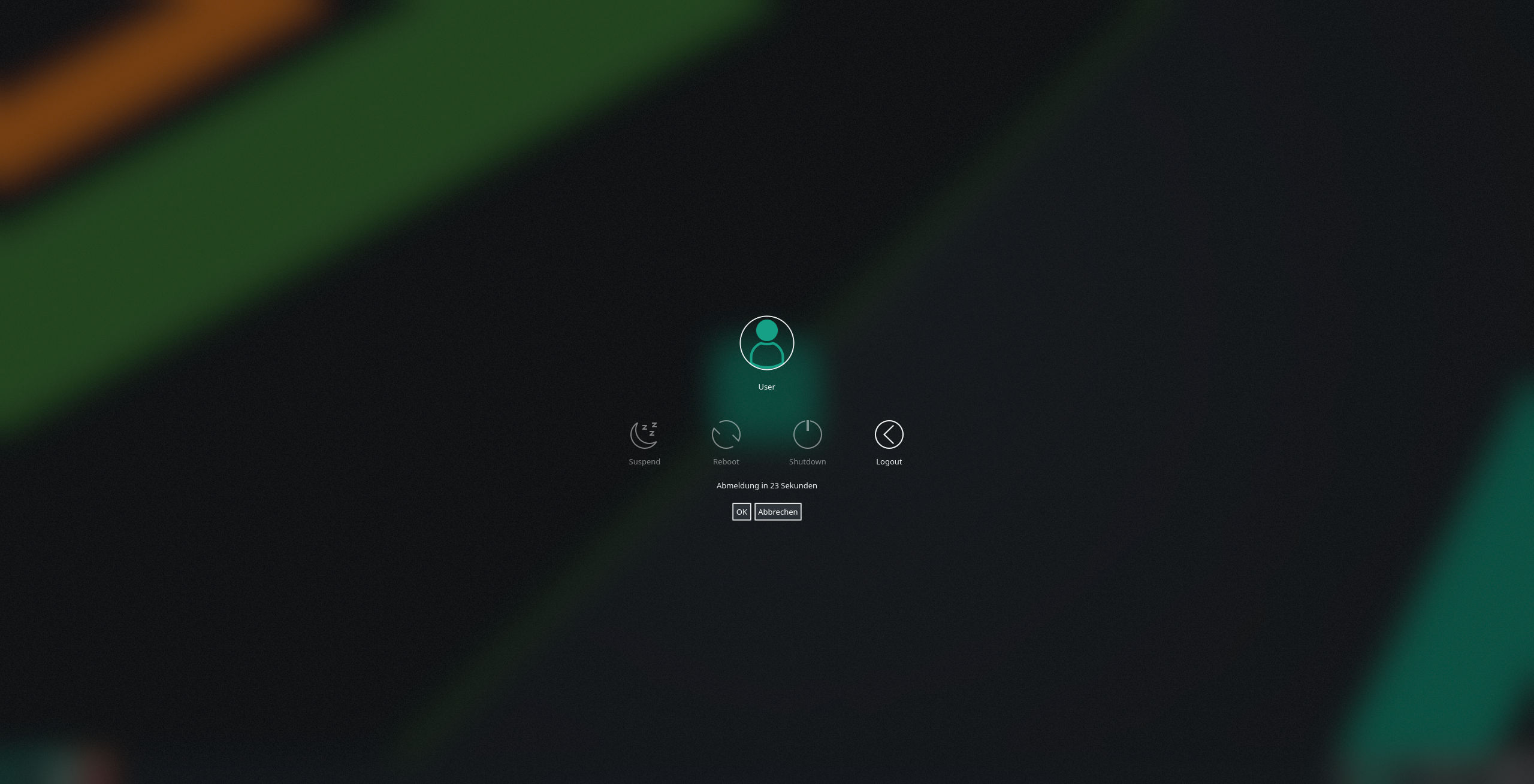

You are not alone, I got the very same situation with another language (German) and it always has been this way sinced I switched to Manjaro KDE with Breath2 1,5 years ago. I regulary set up Manjaro in virtual machines from scratch and it is reproducible there.

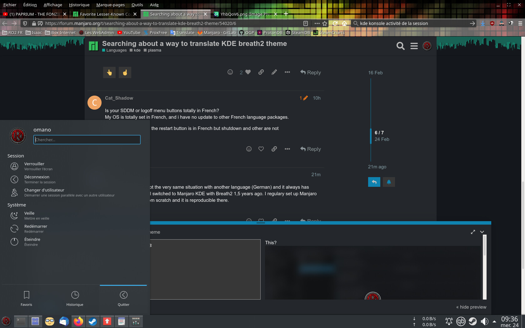

This?
This?

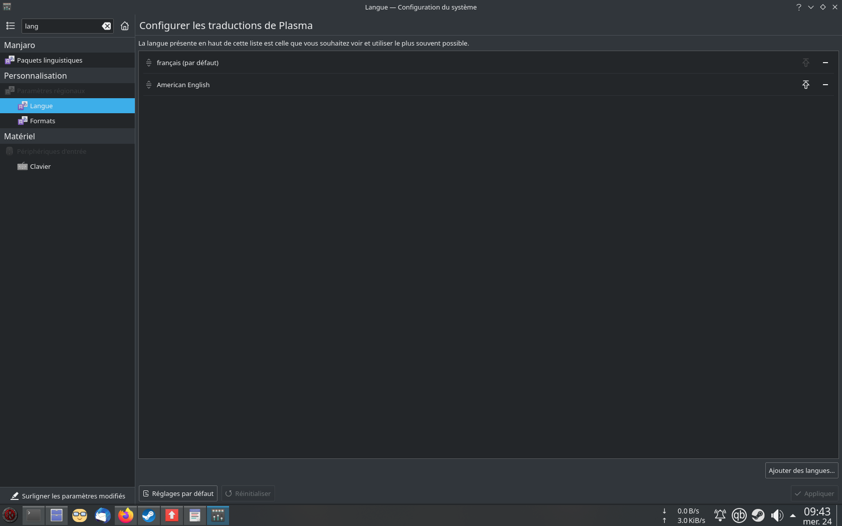

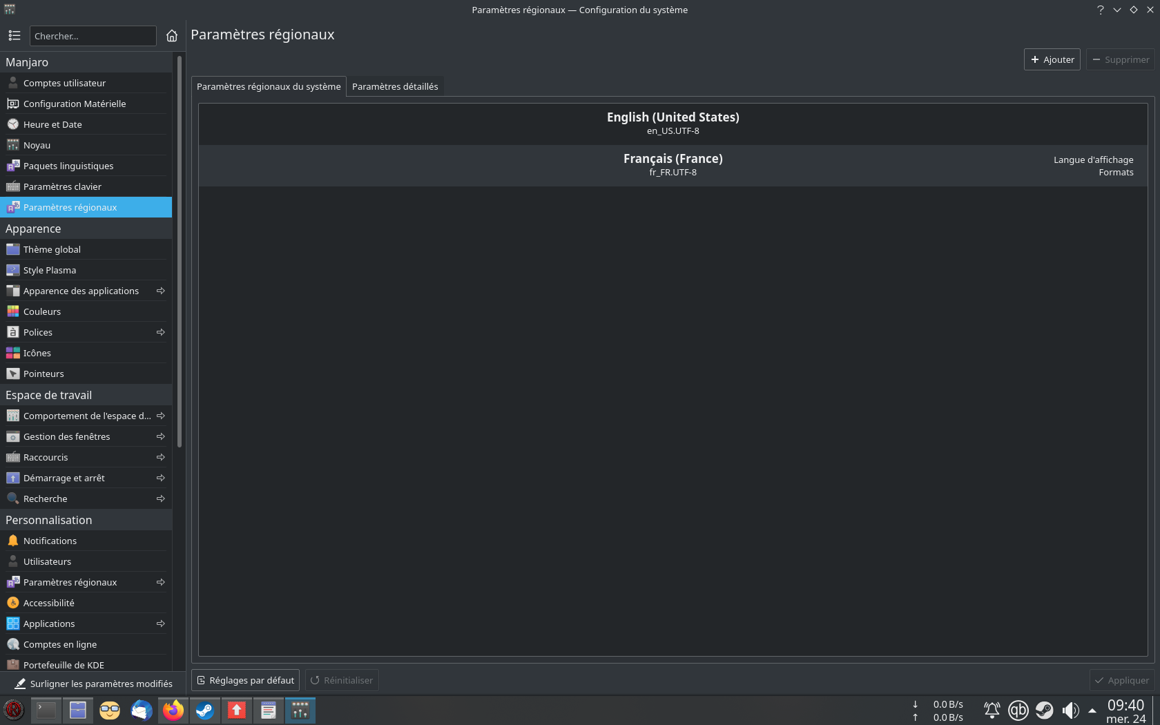

My settings:
first picture: ok for me
second picture: shutdown in french and other items in english
same settings

NB: i cannot send picture on the chat
