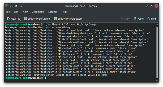

Scribus appimage 1.5.7 fails to run on Manjaro
First I thought the appimage has some problem, but after trying it on Mate it works fine, on Manjaro it fails to be launched and gives the following output :
Similar issues have been fixed with sudo fc-cache -f -v
or
sudo rm /var/cache/fontconfig/*
rm ~/.cache/fontconfig/*
fc-cache -r
It didn’t work :frowning:

Hi @medmedin,
I have no idea what your issue might be. Just to say, I checked now, with a fully updated Manjaro KDE I just downloaded the .AppImage, and as you can see in thee screenshot below
there doesn’t seem to be any problem.
Strange… i was curious and downloaded it myself.
https://sourceforge.net/projects/scribus/files/scribus-devel/1.5.7/
Does not work (Gnome3::Stable-Branch):
./scribus-1.5.7-linux-x86_64.AppImage                                                         ✔
Run experimental bundle that bundles everything
Gtk-Message: 16:10:59.810: Failed to load module "canberra-gtk-module"
Qt: Session management error: None of the authentication protocols specified are supported
QApplication: invalid style override 'kvantum' passed, ignoring it.
	Available styles: gtk2, Windows, Fusion

Fontconfig warning: FcPattern object weight does not accept value [40 210)
zsh: segmentation fault (core dumped)  ./scribus-1.5.7-linux-x86_64.AppImage
Unstable is risky, tried it before and got my system broken after messing with system config files.
Are on stable branch ?

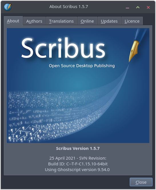

Interesting. Because mine worked fine:
$  ./scribus-1.5.7-linux-x86_64.AppImage
Fontconfig warning: "/etc/fonts/conf.d/10-hinting-slight.conf", line 4: unknown element "description"
Fontconfig warning: "/etc/fonts/conf.d/10-scale-bitmap-fonts.conf", line 4: unknown element "description"
Fontconfig warning: "/etc/fonts/conf.d/20-unhint-small-vera.conf", line 4: unknown element "description"
Fontconfig warning: "/etc/fonts/conf.d/30-metric-aliases.conf", line 4: unknown element "description"
Fontconfig warning: "/etc/fonts/conf.d/40-nonlatin.conf", line 4: unknown element "description"
Fontconfig warning: "/etc/fonts/conf.d/45-generic.conf", line 4: unknown element "description"
Fontconfig warning: "/etc/fonts/conf.d/45-latin.conf", line 4: unknown element "description"
Fontconfig warning: "/etc/fonts/conf.d/49-sansserif.conf", line 4: unknown element "description"
Fontconfig warning: "/etc/fonts/conf.d/50-user.conf", line 4: unknown element "description"
Fontconfig warning: "/etc/fonts/conf.d/51-local.conf", line 4: unknown element "description"
Fontconfig warning: "/etc/fonts/conf.d/60-generic.conf", line 4: unknown element "description"
Fontconfig warning: "/etc/fonts/conf.d/60-latin.conf", line 4: unknown element "description"
Fontconfig warning: "/etc/fonts/conf.d/65-nonlatin.conf", line 4: unknown element "description"
pathForIcon: Unable to load icon /tmp/.mount_scribuTcThgH/lib/x86_64-linux-gnu/../share/scribus/icons/1_5_1/lab.png: File not found
pathForIcon: Unable to load icon /tmp/.mount_scribuTcThgH/lib/x86_64-linux-gnu/../share/scribus/icons/1_5_1/spot.png: File not found
pathForIcon: Unable to load icon /tmp/.mount_scribuTcThgH/lib/x86_64-linux-gnu/../share/scribus/icons/1_5_1/register.png: File not found
qt.gui.icc: Unsupported ICC profile class 70727472
QPngHandler: Failed to parse ICC profile
I might be wrong, it wouldn’t surprise me, but it looks like it has something to do with GTK.
Edit:
And it would seem I am wrong, indeed. According to this page,
sudo fc-cache -f -v
should have worked, but according to @medmedin it did not. So I’m suggesting @medmedin try the manual way suggested by @Emqu:
fc-cache -r
Yes, indeed.
Fyi; the manual way did the trick for me with the AppImage (Gnome 40, unstable branch)

Fontconfig warning: “/etc/fonts/conf.d/30-metric-aliases.conf”, line 4: unknown element “description”
Fontconfig warning: “/etc/fonts/conf.d/40-nonlatin.conf”, line 4: unknown element “description”
Fontconfig warning: “/etc/fonts/conf.d/45-generic.conf”, line 4: unknown element “description”
Fontconfig warning: “/etc/fonts/conf.d/45-latin.conf”, line 4: unknown element “description”
Fontconfig warning: “/etc/fonts/conf.d/49-sansserif.conf”, line 4: unknown element “description”
Fontconfig warning: “/etc/fonts/conf.d/50-user.conf”, line 4: unknown element “description”
Fontconfig warning: “/etc/fonts/conf.d/51-local.conf”, line 4: unknown element “description”
Fontconfig warning: “/etc/fonts/conf.d/60-generic.conf”, line 4: unknown element “description”
Fontconfig warning: “/etc/fonts/conf.d/60-latin.conf”, line 4: unknown element “description”
Fontconfig warning: “/etc/fonts/conf.d/65-nonlatin.conf”, line 4: unknown element “description”
Fontconfig warning: “/etc/fonts/conf.d/70-no-bitmaps.conf”, line 4: unknown element “its:rules”
Fontconfig warning: “/etc/fonts/conf.d/70-no-bitmaps.conf”, line 5: unknown element “its:translateRule”
Fontconfig error: “/etc/fonts/conf.d/70-no-bitmaps.conf”, line 5: invalid attribute ‘translate’
Fontconfig error: “/etc/fonts/conf.d/70-no-bitmaps.conf”, line 5: invalid attribute ‘selector’
Fontconfig error: “/etc/fonts/conf.d/70-no-bitmaps.conf”, line 6: invalid attribute ‘xmlns:its’
Fontconfig error: “/etc/fonts/conf.d/70-no-bitmaps.conf”, line 6: invalid attribute ‘version’
Fontconfig warning: “/etc/fonts/conf.d/70-no-bitmaps.conf”, line 8: unknown element “description”
No problems on Mint XFCE with the same appimage…
