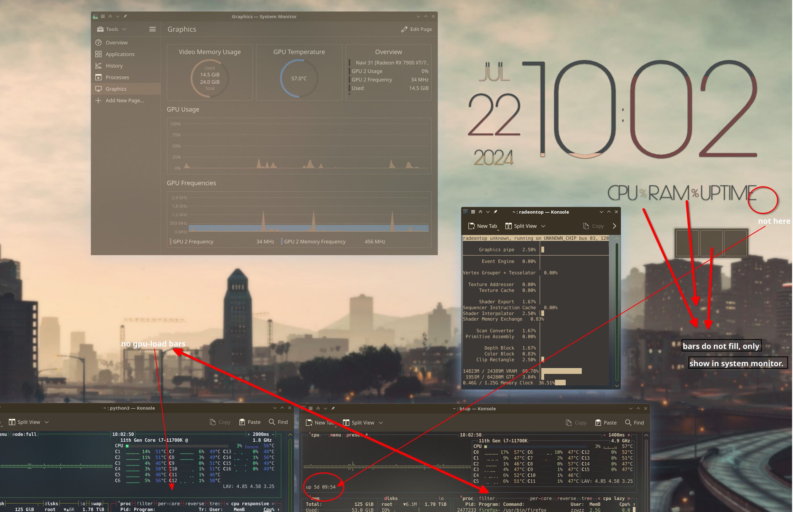

I get all info (no fan speed) in radeontop and in the System Monitor (with a downladed GPU page), but not on widgets.
Shown-below widgets are System Load Viewer and Aesthetic Clock (no info at all on Simple Monitor as well), but this is on MX Linux right now. These widgets do not work in Plasma 6.
