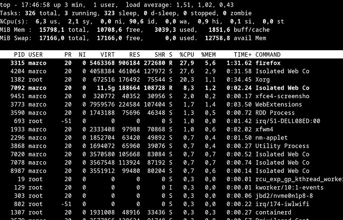

I am not getting any help.
@soundofthunder do you know if there are possible problems in the kernel? I still have issues in clicking the mouse.
There is always potential for incompatibility with so many possible hardware configurations.

Unfortunately with Kernel 6.18 firefox brings the fan to the max level immediately.
I think there should be a problem with interrupts because the CPU load is low:
Then the only viable option (kernel-wise) may be 6.12 (LTS).
I’d suggest switching to and remaining with 6.12 (LTS) throughout any further testing.
I’ve also seen that the 575xx driver series has been suggested for laptops. Maybe that’s worth trying – use the same procedure as before.
Thanks @soundofthunder
It looks like after last updates the situation improved and I do not have the problem with the fan anymore. I am using kernel 6.17. I will try also 6.18 but since yesterday 6.18 was not working well.
@mgazzin
As already stated kernel 6.17 has reached EOL, which means no more updates; no more support.
You could try the 575xx series drivers to see if that brings any improvement in combination with kernel 6.18 (LTS).
Otherwise, if kernel 6.12 (LTS) was working for you, I’d suggest reverting to that and remaining with it, at least for the time being.
