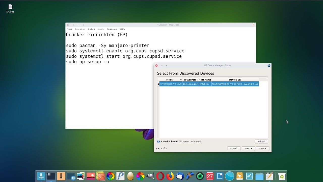

you can install “debtap” from the aur that converts deb-packages and give it a try. check the internet for further handling of debtap but it should be more easy to use “cups” to install brother-printers.
here’s a howto at youtube, it’s german but it’s self-declaring. you’ll find much more searching for “manjaro brother cups”.
