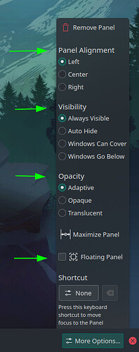

Went trough all the Panel options and
all work as expected.
I chose the Safe Landing wallpaper, is quite bright and should pass trough if there was a gap there. Switched between Breath (that uses the color-scheme) and Breath Dark and still no gap

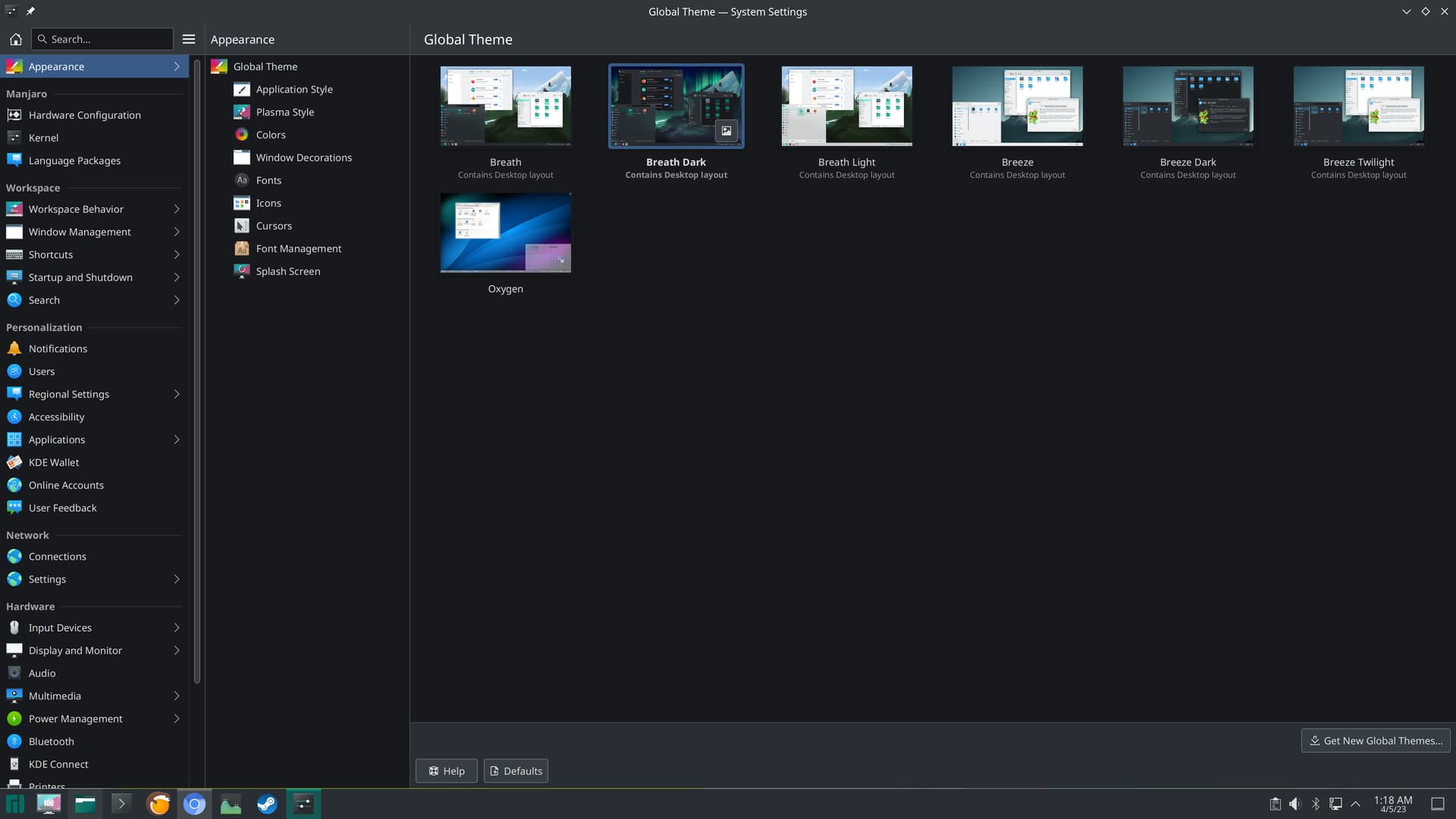

Alright. Things are pretty strange now.
So these are my “steps”
Apply a theme, In this case breeze dark.
The gap goes away, in the theme menu.
The problem still exists on dolphin
Log out, and the problem now exists in the global theme menu again.
Apply a different theme, in this case, breath dark again. The problem goes away in the theme menu again.
rinse and repeat
So it really is not a matter of just using a breeze after all. And on this note, I am going to call it a night.
