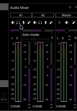

Probably a change in Kdenlive. Go to View and check the āAudio Mixerā checkbox, then try this:
⦠A1 and A2 labels change to orange and green. green being the active one.

So I take it from this that āSolo Modeā also makes no difference?
⦠For the themes, itās set in Manjaro. No modification to Kdenlive or other programs. Youāll need to try them to see which looks best for you. ![]()
Yes, no difference.

Sorry it didnāt help but worth a try.
