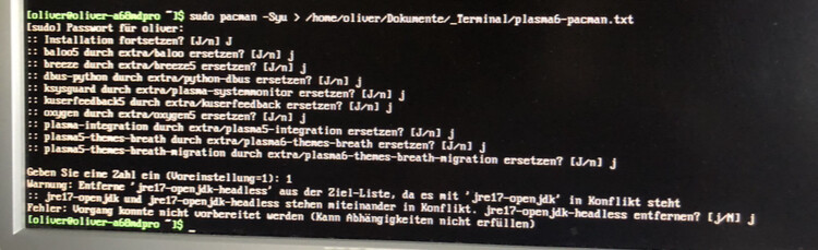

This was the content of the output file and in the tty where I executed pacman the following was written (which was not saved in the output file and therefore can only be shown by screenshots):
Again, the process was aborted.
The update seems to be getting in the way again. Is it necessary to remove the AUR software before the update in order to reinstall it later, or can it simply be rebuilt in its current state?
Or do you have other ideas or hints for me ?
