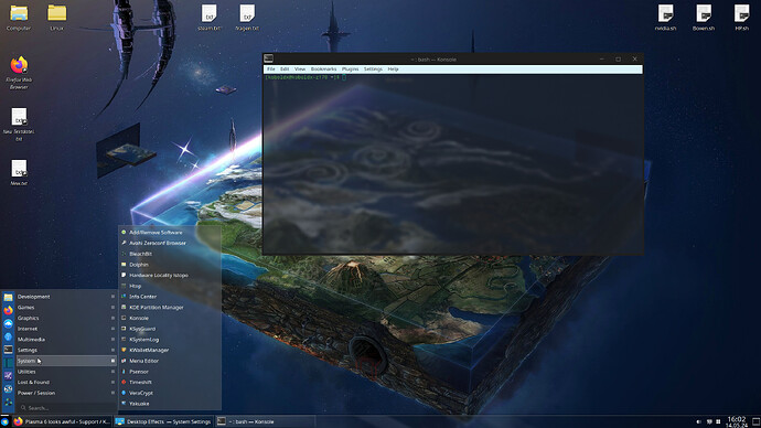

I mean this visual effect for Terminal/Taskbar:
TBH i can’t remember how in the past i activated this Transparency effect, but it isn’t Blur only… and the Transluency effect is unchecked for me when i look at desktop effects menue.
You can achieve certain level of transparency in panel and widgets using the default Breeze theme, but it won’t reach that level you showed in the above image.
You should find a Plasma 6 theme that supports that transparent look.

Transparency in konsole is done within the konsole’ settings
For the taskbar, i don’t know, i was using xfce before Plasma 6 :slight_smile:
Why on earth use nemo on KDE?
@Kobold panel transparency is either a … panel option, or decided by your plasma style.

As for the panel — it is called “a panel”, @ChrisCanyon, and the task bar is only a widget on the panel :stuck_out_tongue: — as others have said, this depends on your chosen Plasma style. Also, and again as others have said, Konsole translucency must be set under the appearance section in your Konsole profile.
Given that you seem to prefer something glossy and black, I would recommend the KDE-supplied (and thus already installed) Oxygen Plasma style. It’s translucent and the translucency has a gradient in it, like looking through black glass.
Anyway, plenty of translucency (with blur) here at my end… :wink: :point_down:
