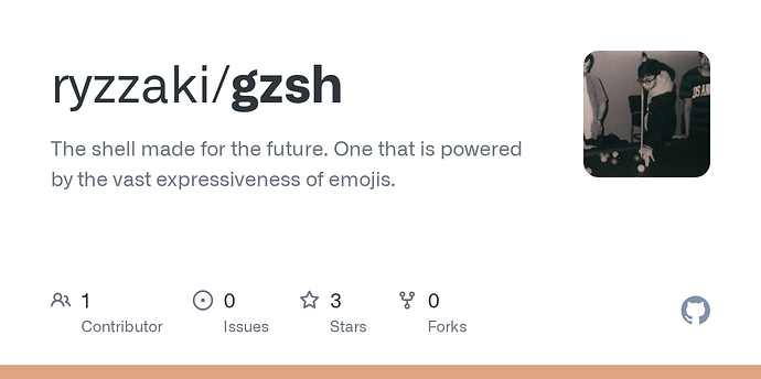

I’m trying to work out what this gzsh is. The only application I can find is a Rust-based terminal that uses emojis for commands, and it hasn’t been updated since September, 2022:
It isn’t in the repos or AUR.
If this terminal is being used for the pamac update command, perhaps a memory leak could be the reason for the RAM filling up? It appears to be very much an abandoned project - just the first commits, and then nothing.
If the above gzsh terminal is not being used, please clarify which terminal you are using.

I just thought it was initial of my username gaurav and followed by zsh, or as I said earlier, there was no separation between the process’s logs and the gzsh terminated pamac update not even space, as much I remember the last words were download started so there is no reason for g to be there but could’ve been next word’s first letter idk…

This is what i wrote. Because of the gzsh in your post it just wasn’t clear to me whether some terminal session terminated or whether the pamac cli terminated. In the latter case it is the old issue i posted. Please notice the pamac cli is merely a frontend to the pamac-daemon, see /usr/bin/pamac-daemon that runs as root (it’s part of the libpamac package). The pamac tray icon and the pamac manager (GUI) are other frontends. To me the whole issue looks like the frontend somehow loses connection to the backend daemon process and terminates itself. This is a bug, but it isn’t crash (there aren’t any stack traces) nor is the issue caused by the upgrading process itself, and hence whether one uses the GUI, the CLI or the TTY doesn’t matter. There is no issue though using pacman instead of pamacso it really seems to be an issue in the pamac code.
Now I understand! Thanks :+1:
I thought pamac cli is something completely different from pacman. That definitely clears that the pamac cli frontend terminated while the daemon in backend was still running as it normally does.
