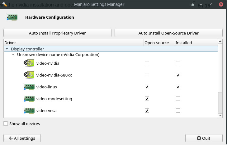

Working on xfce, I have got a problem with nvidia RTX5050 that had been working fine until now. After the last update, the graphics are slower and clearly limited with a drop of fps when gaming and finally, freezing.
Acording to nvidia driver base the new driver is 595 but only 580 is available until now and I assume this would be working. I cannot activate v580 as it is conflicting with the open nvidia
manjaro-settings-manager
gives
config 'video-nvidia-580xx' conflicts with config(s): video-nvidia
I did also make other intents with mhwd and forcing install of the new driver but all this enter in conflict with the nvidia installation and does not conclude.
Finally, I am a bit confused by the output of

This does not work and I did uninstall.
Back again to the driver that is not working completely

sudo mhwd -i pci video-nvidia-580xx   > Error: config 'video-nvidia-580xx' conflicts with config(s): video-nvidia
The first Error indicates that gpu-control is the problem and I remember I installed it a week ago. I will try to remove it first.
The second Error suggests that the solution might be with the configs??? Any idea?

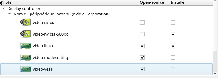

Eliminating gpu-control did clarify a bit and I am on the good way but not yet sure of the result.

Changing to 610: sorry I feel a bit stupid but I do not know how to reinstall the driver 610.
sudo pacman -S linux618-nvidia-open
resolving dependencies...
:: nvidia-utils-610.43.02-2 and nvidia-580xx-utils-580.159.04-1 are in conflict (nvidia-libgl). Remove nvidia-580xx-utils? [y/N] y
:: removing nvidia-580xx-utils breaks dependency 'nvidia-580xx-utils=580.159.04' required by linux612-nvidia-580xx-open
:: removing nvidia-580xx-utils breaks dependency 'nvidia-580xx-utils=580.159.04' required by linux618-nvidia-580xx-open
:: removing nvidia-580xx-utils breaks dependency 'nvidia-580xx-utils=580.159.04' required by linux71-nvidia-580xx-open
:: removing nvidia-580xx-utils breaks dependency 'nvidia-utils=580.159.04' required by nvidia-580xx-settings
Vulkan: I do not know anything about Vulkan yet but here is the current status .

I feel that there is something wrong still.
I have a contradicting information with driver 580 which is l apparently also active.
  • nvidia-smi confirms the use of driver 610/open
  • pamac does not help much, I do not understand what can be installed and/or is missing as there are few proposals with the reference “610”, while I would supress others with reference “580”
  • manjaro-setting-manager still shows that I cannot remove as the suppression of libxnvctrl-580xx breaks necessary dependencies of libxnvctrl for xfce4-sensors-plugin
