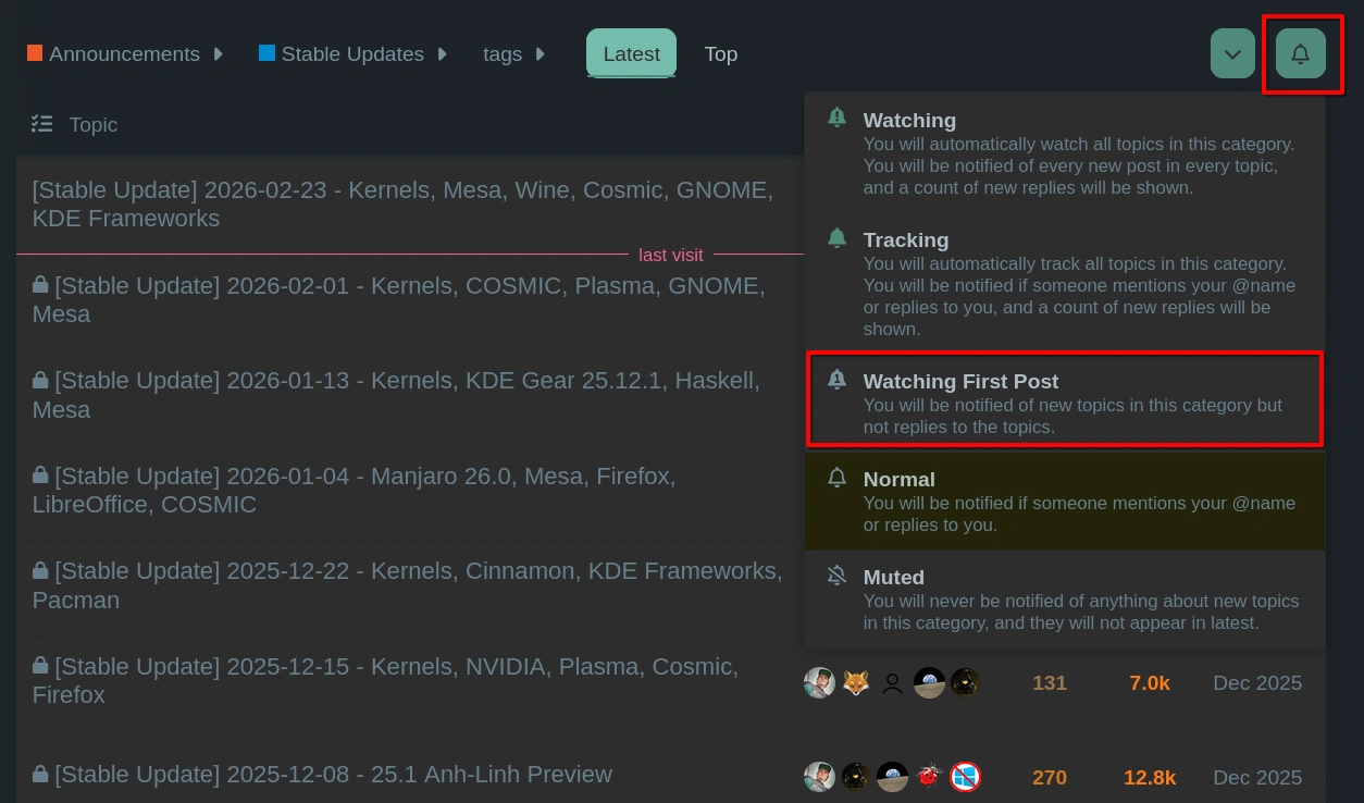

Alternatively, or in addition, you can be notified via email when there is an update. The email will contain the first post of the update announcement, and a link to the topic.
All you need to do is visit Latest Announcements/Stable Updates topics - Manjaro Linux Forum. Then click on the notification bell at top right, and select “Watching First Post”:
You will then be notified whenever a new topic is created in the Stable Updates section of the forum.
