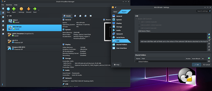

Ok so I got windows running in virtualbox. Problem is I don’t know how to pipe my drives into there. Any advice?
You’ll need to go into the VB machine settings (with the virtual machine not running, or paused etc. otherwise you won’t be able to change the settings), and add a USB controller.
Then you should be able to attach your USB drive and select it from a list of “detected devices”.
I don’t have any VMs set up on this particular machine yet, so will have to get back to you with e.g. screenshots later, if you need them. :wink:
Screenshots would be super helpful thanks. I don’t need any data from the drives right now so no rush.
Turns out I did have a few VMs copied over, just not all of them:

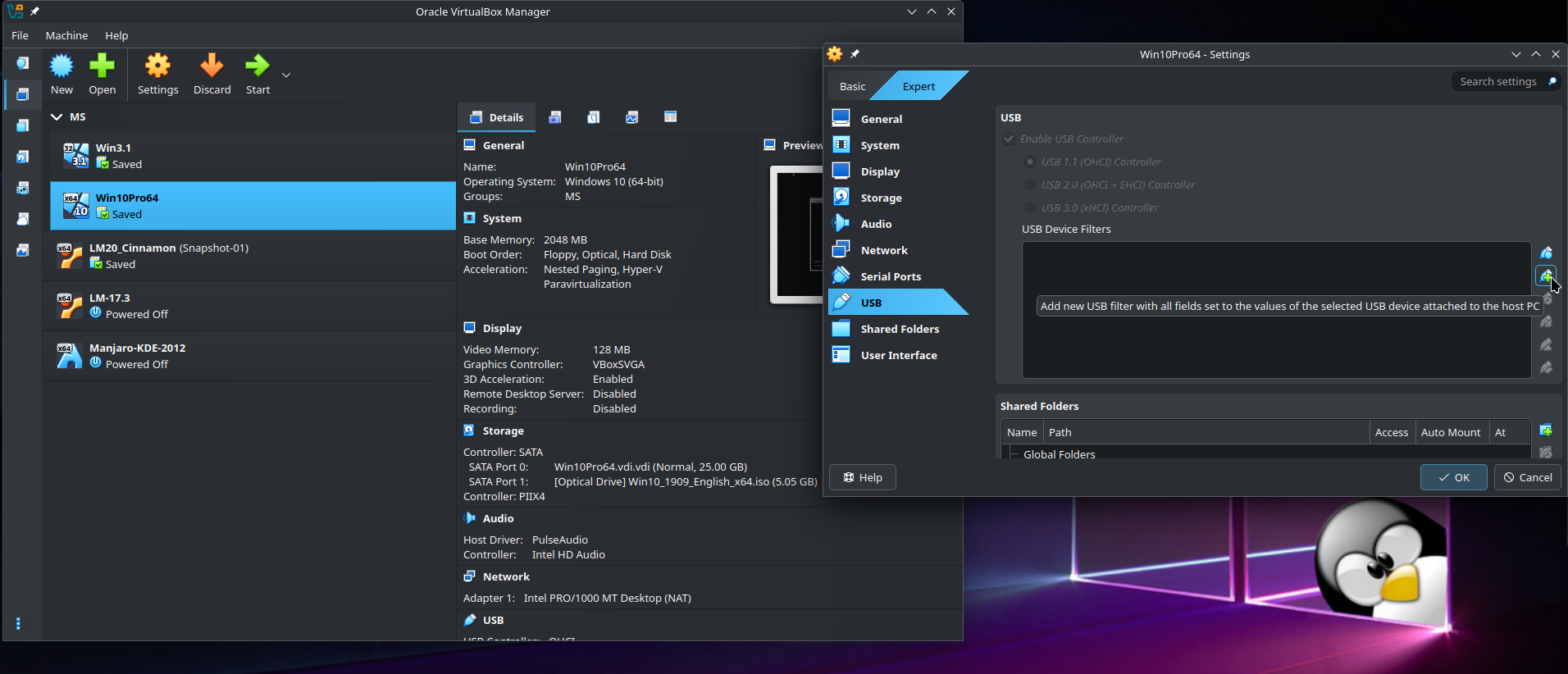

… See where my mouse pointer is? I think that’s what you’ll need to select. I don’t have any USB storage attached at the moment, though, and that VM is in a “Saved” state so not sure if I could add one anyway.

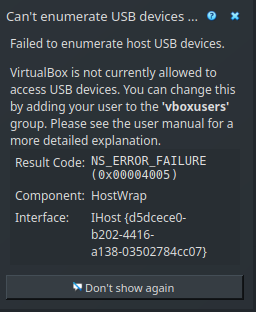

It’s not detecting my usb devices. I tried installing the virtualbox extension pack and that didn’t help.

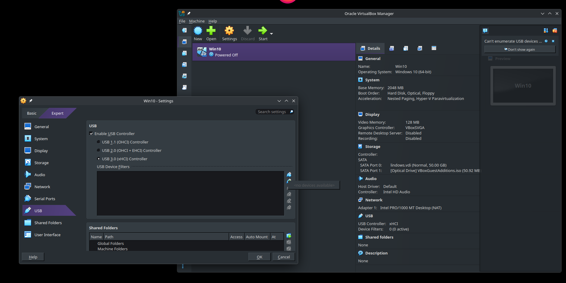

Is the VM you set up in a “Powered Off” state? Otherwise the options for USB type etc. will be greyed-out (unselectable) anyway.
I just switched to one of the others which is “Powered Off”, and the USB device (a Ventoy-formatted stick) I’d plugged in prior to this showed up straight away. :thinking:
Yes it is.
edit: I saw the error. trying to figure out what that means in the manual
I think the top image you just added explains it. I completely forgot about that, sorry.
ETA:
sudo usermod -aG vboxusers $USER
should fix this. It’s been ages since I originally set up VirtualBox so had to dig that one up. :wink:
