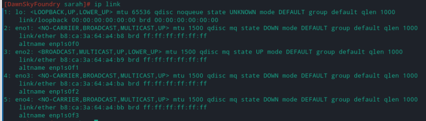

Sarah
25 May 2021 15:53
9
Yikes, didn’t appear. Those 4 are from the integrated NIC, not the myricom
Never mind, I ran that on the server, not the ISO.
Computer administration is so much fun
Sarah
25 May 2021 15:59
11
linux-aarhus:
ip link
I think this is what we wanted right?
So now I have the interface name?
Please do not post screenshots of terminal output. Use copy+paste and proper post formatting (</> button).
That is exactly what you want
