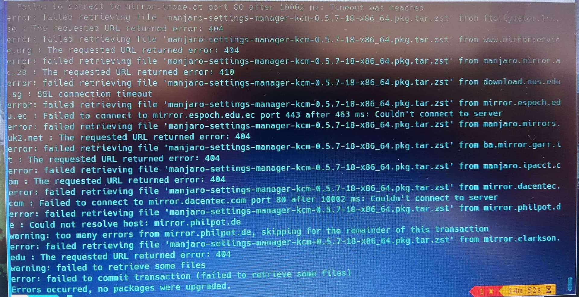

Los comandos que me mandas para ordenar las listas de réplicas dieron error.
Lo siguiente que hice como me dijiste fue eliminar lib32-libelf con el comando sudo Pacman -Rdd lib32-libelf
Y después puse el comando sudo pacman -Syu, de momento sigue actualizando.

¿De verdad ejecutaste:
pacman-mirrors -f
y luego
pacman -Syu
Esta imagen no lo parece.
(Por favor, no publiques imágenes; puedes copiar y pegar el texto…)
Necesitamos ver qué viste y qué hiciste.
Completamente.

manjaro-settings-manager-kcm-0.5.7-18-x86_64.pkg.tar.zst failed to download
Total ( 51/458) 1326.1 MiB 1611 KiB/s 14:03 \[####################################\] 100%
error: failed retrieving file 'lib32-llvm-libs-1:20.1.8-1-x86_64.pkg.tar.zst' from mirror.rise.ph : The requested URL returned error: 403
error: failed retrieving file 'lib32-llvm-libs-1:20.1.8-1-x86_64.pkg.tar.zst' from mirror.catn.com : Failed to connect to mirror.catn.com port 80 after 10002 ms: Timeout was reached
error: failed retrieving file 'lib32-icu-76.1-1-x86_64.pkg.tar.zst' from mirror.rise.ph : The requested URL returned error: 403
error: failed retrieving file 'lib32-icu-76.1-1-x86_64.pkg.tar.zst' from mirror.catn.com : Failed to connect to mirror.catn.com port 80 after 10002 ms: Timeout was reached
error: failed retrieving file 'lib32-opus-1.5.2-1-x86_64.pkg.tar.zst' from mirror.rise.ph : The requested URL returned error: 403
warning: too many errors from mirror.rise.ph, skipping for the remainder of this transaction
error: failed retrieving file 'lib32-opus-1.5.2-1-x86_64.pkg.tar.zst' from mirror.catn.com : Failed to connect to mirror.catn.com port 80 after 10002 ms: Timeout was reached
warning: too many errors from mirror.catn.com, skipping for the remainder of this transaction
error: failed retrieving file 'manjaro-settings-manager-kcm-0.5.7-18-x86_64.pkg.tar.zst' from ftp.halifax.rwth-aachen.de : The requested URL returned error: 404
error: failed retrieving file 'manjaro-settings-manager-kcm-0.5.7-18-x86_64.pkg.tar.zst' from mirrors.shuosc.org : Could not resolve host: mirrors.shuosc.org
warning: too many errors from mirrors.shuosc.org, skipping for the remainder of this transaction
error: failed retrieving file 'manjaro-settings-manager-kcm-0.5.7-18-x86_64.pkg.tar.zst' from mirror.koddos.net : The requested URL returned error: 404
error: failed retrieving file 'manjaro-settings-manager-kcm-0.5.7-18-x86_64.pkg.tar.zst' from ftp.belnet.be : Failed to connect to ftp.belnet.be port 80 after 149 ms: Couldn't connect to server
error: failed retrieving file 'manjaro-settings-manager-kcm-0.5.7-18-x86_64.pkg.tar.zst' from manjaro.mirror.garr.it : The requested URL returned error: 404
error: failed retrieving file 'manjaro-settings-manager-kcm-0.5.7-18-x86_64.pkg.tar.zst' from mirror.xeonbd.com : The requested URL returned error: 404
error: failed retrieving file 'manjaro-settings-manager-kcm-0.5.7-18-x86_64.pkg.tar.zst' from kambing.ui.ac.id : Failed to connect to kambing.ui.ac.id port 80 after 10002 ms: Couldn't connect to server
error: failed retrieving file 'manjaro-settings-manager-kcm-0.5.7-18-x86_64.pkg.tar.zst' from manjaro.barata.pt : Could not resolve host: manjaro.barata.pt
warning: too many errors from manjaro.barata.pt, skipping for the remainder of this transaction
error: failed retrieving file 'manjaro-settings-manager-kcm-0.5.7-18-x86_64.pkg.tar.zst' from mirror.netzspielplatz.de : Failed to connect to mirror.netzspielplatz.de port 443 after 10001 ms: Timeout was reached
error: failed retrieving file 'manjaro-settings-manager-kcm-0.5.7-18-x86_64.pkg.tar.zst' from ftp.free.org : The requested URL returned error: 404
error: failed retrieving file 'manjaro-settings-manager-kcm-0.5.7-18-x86_64.pkg.tar.zst' from mirrors.tuna.tsinghua.edu.cn : The requested URL returned error: 404
error: failed retrieving file 'manjaro-settings-manager-kcm-0.5.7-18-x86_64.pkg.tar.zst' from mirrors.ustc.edu.cn : The requested URL returned error: 404
error: failed retrieving file 'manjaro-settings-manager-kcm-0.5.7-18-x86_64.pkg.tar.zst' from mirror.tuchola-dc.pl : Failed to connect to mirror.tuchola-dc.pl port 443 after 10002 ms: Couldn't connect to server
error: failed retrieving file 'manjaro-settings-manager-kcm-0.5.7-18-x86_64.pkg.tar.zst' from mirror.math.princeton.edu : The requested URL returned error: 404
error: failed retrieving file 'manjaro-settings-manager-kcm-0.5.7-18-x86_64.pkg.tar.zst' from mirror.ragenetwork.de : Could not resolve host: mirror.ragenetwork.de
warning: too many errors from mirror.ragenetwork.de, skipping for the remainder of this transaction
error: failed retrieving file 'manjaro-settings-manager-kcm-0.5.7-18-x86_64.pkg.tar.zst' from ftp.snt.utwente.nl : The requested URL returned error: 404
error: failed retrieving file 'manjaro-settings-manager-kcm-0.5.7-18-x86_64.pkg.tar.zst' from ftp.nluug.nl : The requested URL returned error: 404
error: failed retrieving file 'manjaro-settings-manager-kcm-0.5.7-18-x86_64.pkg.tar.zst' from ftp.linux.org.tr : The requested URL returned error: 404
error: failed retrieving file 'manjaro-settings-manager-kcm-0.5.7-18-x86_64.pkg.tar.zst' from ftp.tu-chemnitz.de : The requested URL returned error: 404
error: failed retrieving file 'manjaro-settings-manager-kcm-0.5.7-18-x86_64.pkg.tar.zst' from mirror.netcologne.de : The requested URL returned error: 404
error: failed retrieving file 'manjaro-settings-manager-kcm-0.5.7-18-x86_64.pkg.tar.zst' from mirrors.ucr.ac.cr : The requested URL returned error: 404
error: failed retrieving file 'manjaro-settings-manager-kcm-0.5.7-18-x86_64.pkg.tar.zst' from ftp.caliu.cat : The requested URL returned error: 404
error: failed retrieving file 'manjaro-settings-manager-kcm-0.5.7-18-x86_64.pkg.tar.zst' from free.nchc.org.tw : The requested URL returned error: 404
error: failed retrieving file 'manjaro-settings-manager-kcm-0.5.7-18-x86_64.pkg.tar.zst' from mirrors.shu.edu.cn : Failed to connect to mirrors.shu.edu.cn port 443 after 929 ms: Couldn't connect to server
error: failed retrieving file 'manjaro-settings-manager-kcm-0.5.7-18-x86_64.pkg.tar.zst' from manjaro.melbourneitmirror.net : Could not resolve host: manjaro.lucassymons.net
warning: too many errors from manjaro.melbourneitmirror.net, skipping for the remainder of this transaction
error: failed retrieving file 'manjaro-settings-manager-kcm-0.5.7-18-x86_64.pkg.tar.zst' from mirror.ventraip.net.au : The requested URL returned error: 404
error: failed retrieving file 'manjaro-settings-manager-kcm-0.5.7-18-x86_64.pkg.tar.zst' from mirror.zetup.net : The requested URL returned error: 404
error: failed retrieving file 'manjaro-settings-manager-kcm-0.5.7-18-x86_64.pkg.tar.zst' from mirrors.netix.net : The requested URL returned error: 404
error: failed retrieving file 'manjaro-settings-manager-kcm-0.5.7-18-x86_64.pkg.tar.zst' from manjaro.moson.eu : Could not resolve host: manjaro.moson.eu
warning: too many errors from manjaro.moson.eu, skipping for the remainder of this transaction
error: failed retrieving file 'manjaro-settings-manager-kcm-0.5.7-18-x86_64.pkg.tar.zst' from mirrors.dotsrc.org : The requested URL returned error: 404
error: failed retrieving file 'manjaro-settings-manager-kcm-0.5.7-18-x86_64.pkg.tar.zst' from mirrors.zju.edu.cn : The requested URL returned error: 404
error: failed retrieving file 'manjaro-settings-manager-kcm-0.5.7-18-x86_64.pkg.tar.zst' from mirror.datacenter.by : The requested URL returned error: 404
error: failed retrieving file 'manjaro-settings-manager-kcm-0.5.7-18-x86_64.pkg.tar.zst' from ftp.riken.jp : The requested URL returned error: 404
error: failed retrieving file 'manjaro-settings-manager-kcm-0.5.7-18-x86_64.pkg.tar.zst' from linorg.usp.br : The requested URL returned error: 404
error: failed retrieving file 'manjaro-settings-manager-kcm-0.5.7-18-x86_64.pkg.tar.zst' from mirror.truenetwork.ru : The requested URL returned error: 404
error: failed retrieving file 'manjaro-settings-manager-kcm-0.5.7-18-x86_64.pkg.tar.zst' from www.uex.dk : The requested URL returned error: 404
error: failed retrieving file 'manjaro-settings-manager-kcm-0.5.7-18-x86_64.pkg.tar.zst' from kartolo.sby.datautama.net.id : The requested URL returned error: 404
error: failed retrieving file 'manjaro-settings-manager-kcm-0.5.7-18-x86_64.pkg.tar.zst' from ftp.rz.tu-bs.de : The requested URL returned error: 404
error: failed retrieving file 'manjaro-settings-manager-kcm-0.5.7-18-x86_64.pkg.tar.zst' from ftp.tsukuba.wide.ad.jp : The requested URL returned error: 404
error: failed retrieving file 'manjaro-settings-manager-kcm-0.5.7-18-x86_64.pkg.tar.zst' from osmirror.org : Failed to connect to osmirror.org port 443 after 10002 ms: Timeout was reached
error: failed retrieving file 'manjaro-settings-manager-kcm-0.5.7-18-x86_64.pkg.tar.zst' from repo.sadjad.ac.ir : The requested URL returned error: 502
error: failed retrieving file 'manjaro-settings-manager-kcm-0.5.7-18-x86_64.pkg.tar.zst' from pet.inf.ufsc.br : Failed to connect to pet.inf.ufsc.br port 80 after 2081 ms: Couldn't connect to server
error: failed retrieving file 'manjaro-settings-manager-kcm-0.5.7-18-x86_64.pkg.tar.zst' from manjaro.c3sl.ufpr.br : The requested URL returned error: 404
error: failed retrieving file 'manjaro-settings-manager-kcm-0.5.7-18-x86_64.pkg.tar.zst' from manjaro.dcc.uchile.cl : The requested URL returned error: 404
error: failed retrieving file 'manjaro-settings-manager-kcm-0.5.7-18-x86_64.pkg.tar.zst' from repo.rhindon.net : Could not resolve host: repo.rhindon.net
warning: too many errors from repo.rhindon.net, skipping for the remainder of this transaction
error: failed retrieving file 'manjaro-settings-manager-kcm-0.5.7-18-x86_64.pkg.tar.zst' from mirror.yandex.ru : The requested URL returned error: 404
error: failed retrieving file 'manjaro-settings-manager-kcm-0.5.7-18-x86_64.pkg.tar.zst' from mirror.upb.edu.co : Could not resolve host: mirror.upb.edu.co
warning: too many errors from mirror.upb.edu.co, skipping for the remainder of this transaction
error: failed retrieving file 'manjaro-settings-manager-kcm-0.5.7-18-x86_64.pkg.tar.zst' from mirrors.sjtug.sjtu.edu.cn : The requested URL returned error: 404
error: failed retrieving file 'manjaro-settings-manager-kcm-0.5.7-18-x86_64.pkg.tar.zst' from mirror.ufam.edu.br : The requested URL returned error: 404
error: failed retrieving file 'manjaro-settings-manager-kcm-0.5.7-18-x86_64.pkg.tar.zst' from repo.manjaro.org.uk : Could not resolve host: repo.manjaro.org.uk
warning: too many errors from repo.manjaro.org.uk, skipping for the remainder of this transaction
error: failed retrieving file 'manjaro-settings-manager-kcm-0.5.7-18-x86_64.pkg.tar.zst' from mirrors.serverhost.ro : Could not resolve host: mirrors.serverhost.ro
warning: too many errors from mirrors.serverhost.ro, skipping for the remainder of this transaction
error: failed retrieving file 'manjaro-settings-manager-kcm-0.5.7-18-x86_64.pkg.tar.zst' from mirror.dkm.cz : The requested URL returned error: 404
error: failed retrieving file 'manjaro-settings-manager-kcm-0.5.7-18-x86_64.pkg.tar.zst' from mirror.infotronik.hu : The requested URL returned error: 404
error: failed retrieving file 'manjaro-settings-manager-kcm-0.5.7-18-x86_64.pkg.tar.zst' from manjaro.telecoms.bg : Failed to connect to manjaro.telecoms.bg port 80 after 2193 ms: Couldn't connect to server
error: failed retrieving file 'manjaro-settings-manager-kcm-0.5.7-18-x86_64.pkg.tar.zst' from kibo.remi.lu : Could not resolve host: kibo.remi.lu
warning: too many errors from kibo.remi.lu, skipping for the remainder of this transaction
error: failed retrieving file 'manjaro-settings-manager-kcm-0.5.7-18-x86_64.pkg.tar.zst' from mirror.chmuri.net : The requested URL returned error: 404
error: failed retrieving file 'manjaro-settings-manager-kcm-0.5.7-18-x86_64.pkg.tar.zst' from distro.ibiblio.org : The requested URL returned error: 404
error: failed retrieving file 'manjaro-settings-manager-kcm-0.5.7-18-x86_64.pkg.tar.zst' from mirror.is.co.za : The requested URL returned error: 404
error: failed retrieving file 'manjaro-settings-manager-kcm-0.5.7-18-x86_64.pkg.tar.zst' from manjaro.cu.be : Could not resolve host: manjaro.cu.be
warning: too many errors from manjaro.cu.be, skipping for the remainder of this transaction
error: failed retrieving file 'manjaro-settings-manager-kcm-0.5.7-18-x86_64.pkg.tar.zst' from mirrors.ocf.berkeley.edu : The requested URL returned error: 404
error: failed retrieving file 'manjaro-settings-manager-kcm-0.5.7-18-x86_64.pkg.tar.zst' from mirror.cedia.org.ec : The requested URL returned error: 404
error: failed retrieving file 'manjaro-settings-manager-kcm-0.5.7-18-x86_64.pkg.tar.zst' from ftp.cc.uoc.gr : The requested URL returned error: 404
error: failed retrieving file 'manjaro-settings-manager-kcm-0.5.7-18-x86_64.pkg.tar.zst' from ct.mirror.garr.it : The requested URL returned error: 404
error: failed retrieving file 'manjaro-settings-manager-kcm-0.5.7-18-x86_64.pkg.tar.zst' from mirror.inode.at : Failed to connect to mirror.inode.at port 80 after 10002 ms: Timeout was reached
error: failed retrieving file 'manjaro-settings-manager-kcm-0.5.7-18-x86_64.pkg.tar.zst' from ftp.lysator.liu.se : The requested URL returned error: 404
error: failed retrieving file 'manjaro-settings-manager-kcm-0.5.7-18-x86_64.pkg.tar.zst' from www.mirrorservice.org : The requested URL returned error: 404
error: failed retrieving file 'manjaro-settings-manager-kcm-0.5.7-18-x86_64.pkg.tar.zst' from manjaro.mirror.ac.za : The requested URL returned error: 410
error: failed retrieving file 'manjaro-settings-manager-kcm-0.5.7-18-x86_64.pkg.tar.zst' from download.nus.edu.sg : SSL connection timeout
error: failed retrieving file 'manjaro-settings-manager-kcm-0.5.7-18-x86_64.pkg.tar.zst' from mirror.espoch.edu.ec : Failed to connect to mirror.espoch.edu.ec port 443 after 463 ms: Couldn't connect to server
error: failed retrieving file 'manjaro-settings-manager-kcm-0.5.7-18-x86_64.pkg.tar.zst' from manjaro.mirrors.uk2.net : The requested URL returned error: 404
error: failed retrieving file 'manjaro-settings-manager-kcm-0.5.7-18-x86_64.pkg.tar.zst' from ba.mirror.garr.it : The requested URL returned error: 404
error: failed retrieving file 'manjaro-settings-manager-kcm-0.5.7-18-x86_64.pkg.tar.zst' from manjaro.ipacct.com : The requested URL returned error: 404
error: failed retrieving file 'manjaro-settings-manager-kcm-0.5.7-18-x86_64.pkg.tar.zst' from mirror.dacentec.com : Failed to connect to mirror.dacentec.com port 80 after 10002 ms: Couldn't connect to server
error: failed retrieving file 'manjaro-settings-manager-kcm-0.5.7-18-x86_64.pkg.tar.zst' from mirror.philpot.de : Could not resolve host: mirror.philpot.de
warning: too many errors from mirror.philpot.de, skipping for the remainder of this transaction
error: failed retrieving file 'manjaro-settings-manager-kcm-0.5.7-18-x86_64.pkg.tar.zst' from mirror.clarkson.edu : The requested URL returned error: 404
warning: failed to retrieve some files
error: failed to commit transaction (failed to retrieve some files)

Hola @Sanchez,
Al parecer necesitas correr otra vez los comandos en la terminal que te sugirió @anon33601770. No sabemos en qué país te encuentras. Te sugirieron spain o germany, puedes cambiarlo por el nombre de tu país en inglés.
Te aconsejo que pruebes eso otra vez:
sudo pacman-mirrors -f 20
sudo pacman -Syu
Los repositorios que has obtenido son lentos. Otra posibilidad es ejecutar:
sudo pacman-mirror --fasttrack
sudo pacman -Syu
La primera de estas dos últimas va a tardar tiempo, busca los repositorios con más velocidad.
Espero que te sirva.
Saludos
