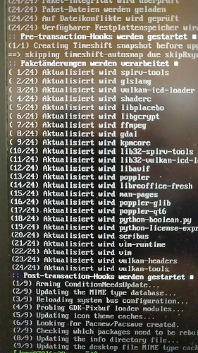

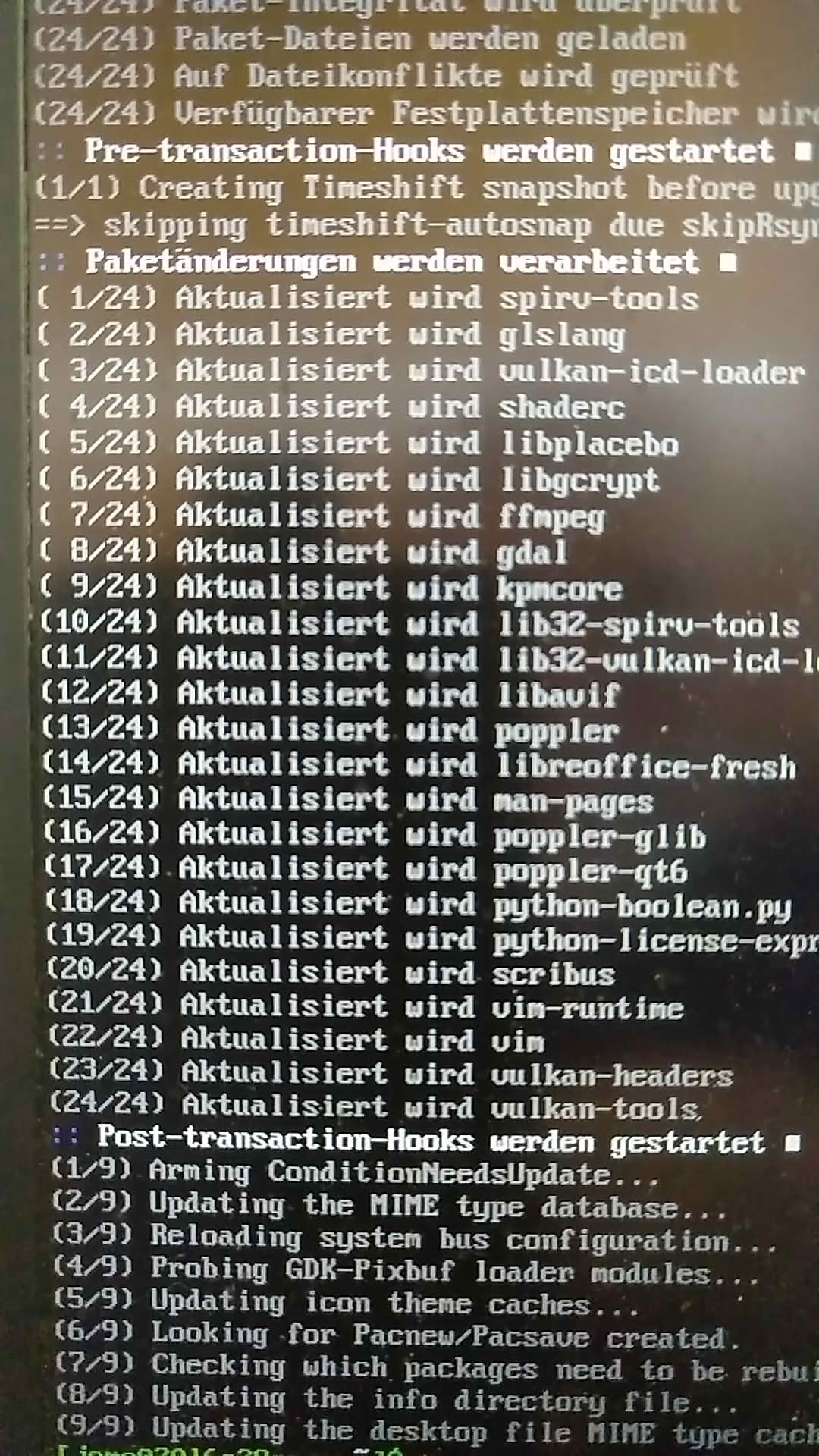

Here is what happens on my system, when updating through TTY:
  1. The update starts the pacnew-checker.hook
  2. The /tmp/pacnew-check.file is not created even there is a pacnew file present
  3. Consequently the manjaro-pacnew-checker script is not started when logged in from TTY back to the desktop enviroment

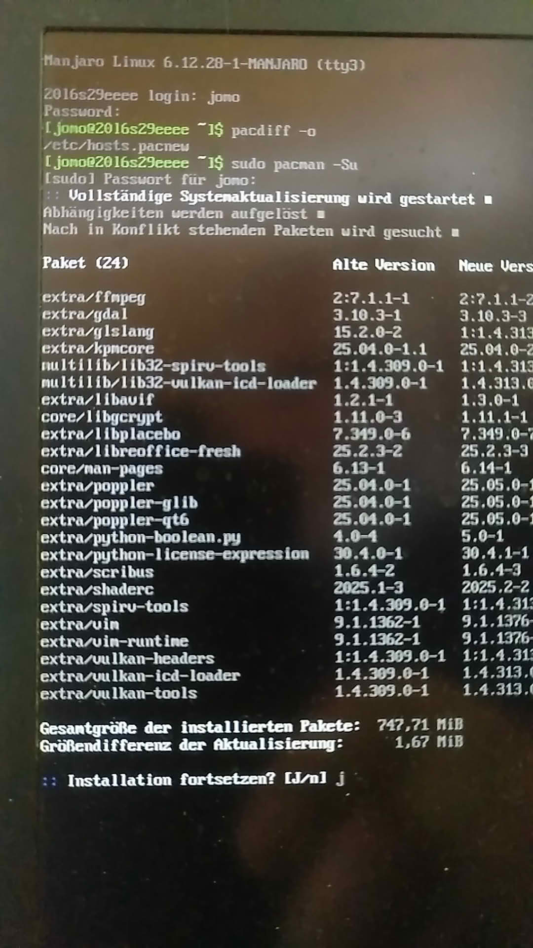

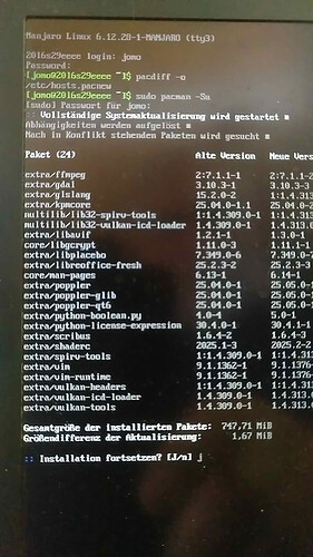

I have attached two snapshots from a TTY session with my above 1. - 3.:
a) there is a pacnew file present at the start of the update
b) pacnew-checker.hook is started
I’m unsure whether that has been design intent or not. If not I would request this as a new feature, unless someone confirms it is only an issue on my system.
