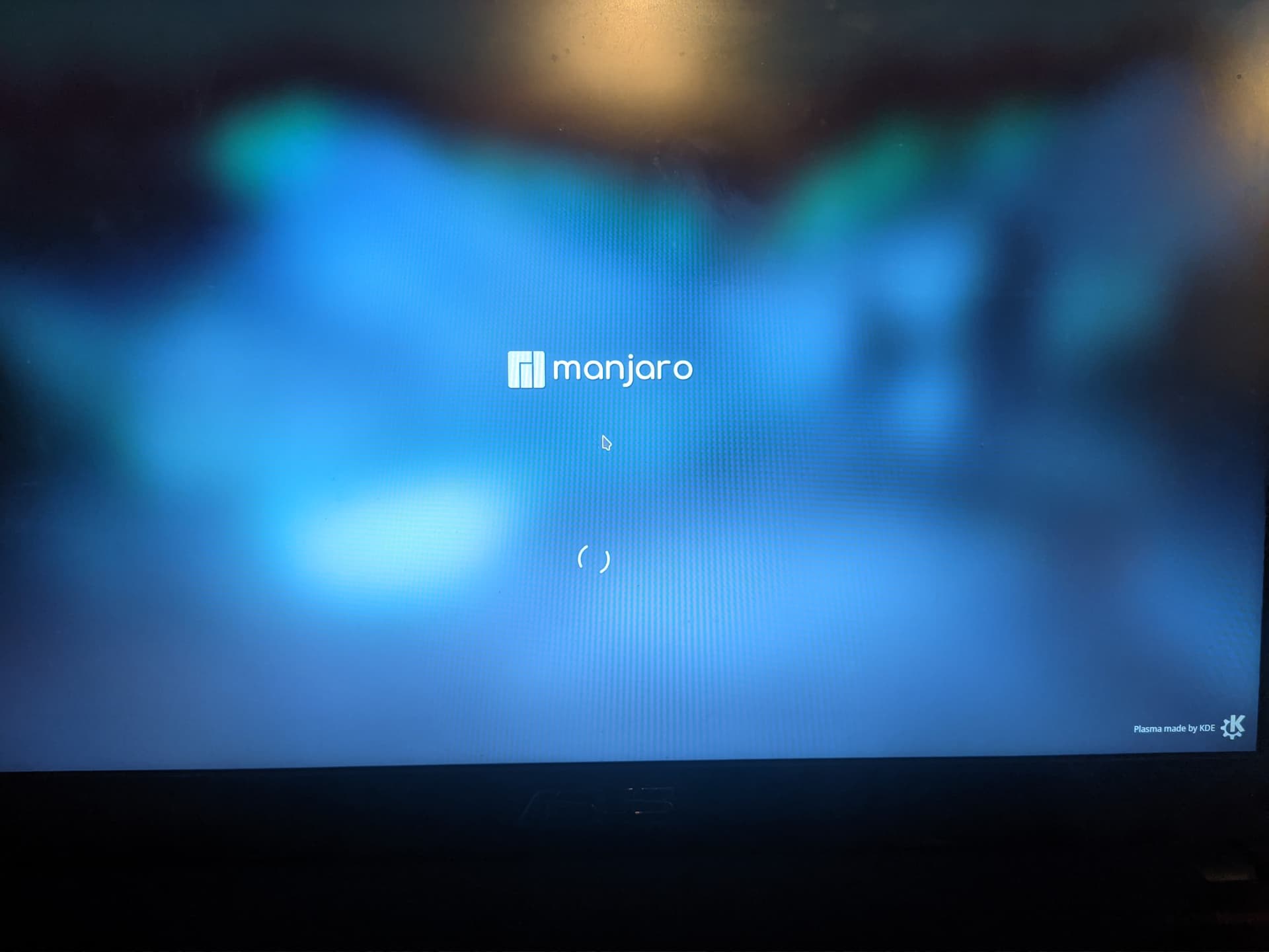

Manjaro KDE not able to boot - Stuck on loading screen

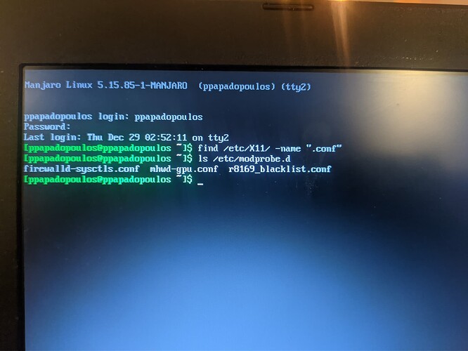

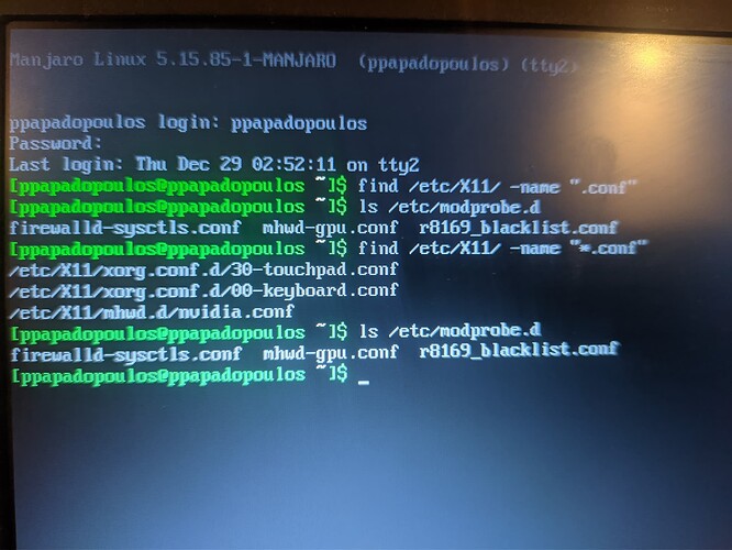

log into tty, and provide output from:
find /etc/X11/ -name "*.conf"
ls /etc/modprobe.d
there are probably some leftovers from it
Second command returned
firewalld-sysctls.conf mhwd-gpu.conf r8169_blacklist.conf
should have taken a picture and post it…
and the first one?
Here you go mate!
you forgot to put * into the find command…
Oh, so sorry. I rerun both.

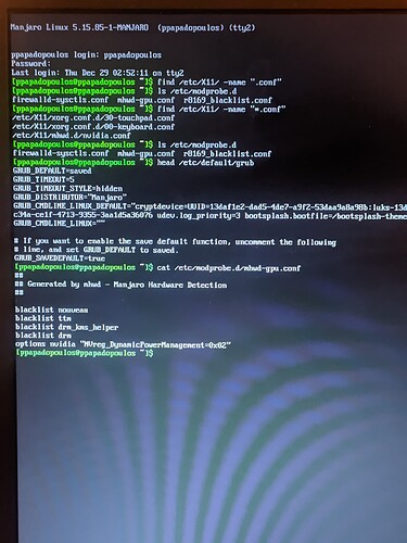

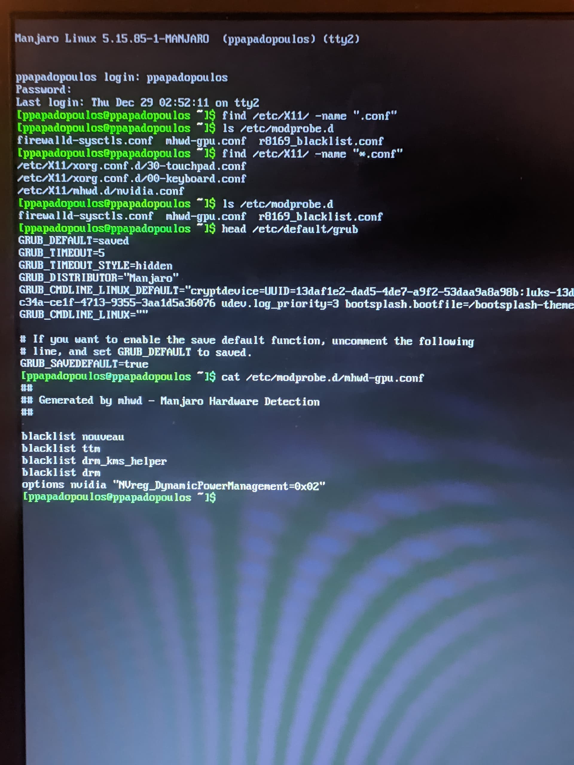

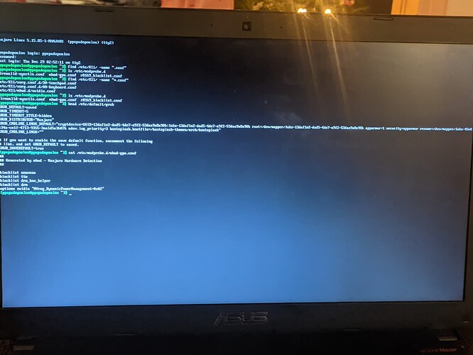

take pic of these:
head /etc/default/grub
cat /etc/modprobe.d/mhwd-gpu.conf
I took 2 pictures
ok, no suspicious kernel parameters… and nvidia is not blacklisted… lets reinstall it again;

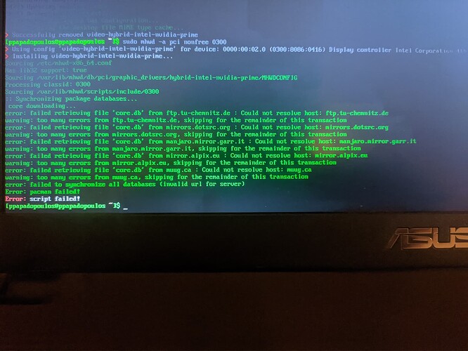

Everything went good, until
sudo mhwd -a pci nonfree 0300
Then this,
you are probably not connected to internet;
You can see available connections with:
nmcli device
And then connect to the wifi connection of your choice with:
nmcli device wifi connect <SSID> password <password>
Being <SSID> the wifi id that you get from the previous command and <password> the password for such wifi.
rerun the install command again
Ok so I’ve managed to connect to the network, installed the package and rebooted. I got past the loading screen all the way up to the login screen where I put my password and then got stuck on this. My mouse is still moving so I don’t really get why.
Could it be a grub parameter?

Dec 29 02:14:06 ppapadopoulos kernel: nouveau 0000:01:00.0: bus: MMIO read of 00000000 FAULT at 6013d4 [ PRIVRING ]
Dec 29 02:14:06 ppapadopoulos systemd-coredump[6721]: Failed to connect to coredump service: Connection refused
Dec 29 02:14:06 ppapadopoulos systemd[1]: udisks2.service: Main process exited, code=dumped, status=6/ABRT
Dec 29 02:14:06 ppapadopoulos systemd[1]: udisks2.service: Failed with result 'core-dump'.
Dec 29 02:14:08 ppapadopoulos kernel: nvidia: loading out-of-tree module taints kernel.
Dec 29 02:14:08 ppapadopoulos kernel: nvidia: module license 'NVIDIA' taints kernel.
Dec 29 02:14:08 ppapadopoulos kernel: Disabling lock debugging due to kernel taint
Dec 29 02:14:08 ppapadopoulos kernel: NVRM: The NVIDIA probe routine was not called for 1 device(s).
Dec 29 02:14:08 ppapadopoulos kernel: NVRM: This can occur when a driver such as:
                                      NVRM: nouveau, rivafb, nvidiafb or rivatv
                                      NVRM: was loaded and obtained ownership of the NVIDIA device(s).
Dec 29 02:14:08 ppapadopoulos kernel: NVRM: Try unloading the conflicting kernel module (and/or
                                      NVRM: reconfigure your kernel without the conflicting
                                      NVRM: driver(s)), then try loading the NVIDIA kernel module
                                      NVRM: again.
Dec 29 02:14:08 ppapadopoulos kernel: NVRM: No NVIDIA devices probed.

The pacman command returned this,

When I ran (the first time, see log at above post) the,
journalctl -b-1 -p4 --no-pager
I got an error/notification as system pop up window that my drive was not accessible or something like that… So afterwards I shutdown and rebooted into the live usb, got into chroot and re ran the above mentioned command. This time I did not get any errors, so I’m posting this log also, in case anything got mixed up the first time.
Dec 29 02:15:11 ppapadopoulos kernel: MDS CPU bug present and SMT on, data leak possible. See https://www.kernel.org/doc/html/latest/admin-guide/hw-vuln/mds.html for more details.

Dec 29 02:15:12 ppapadopoulos kernel: nvidia: loading out-of-tree module taints kernel.
Dec 29 02:15:12 ppapadopoulos kernel: nvidia: module license 'NVIDIA' taints kernel.
Dec 29 02:15:12 ppapadopoulos kernel: Disabling lock debugging due to kernel taint
Dec 29 02:15:13 ppapadopoulos kernel: NVRM: loading NVIDIA UNIX x86_64 Kernel Module  525.60.11  Wed Nov 23 23:04:03 UTC 2022
