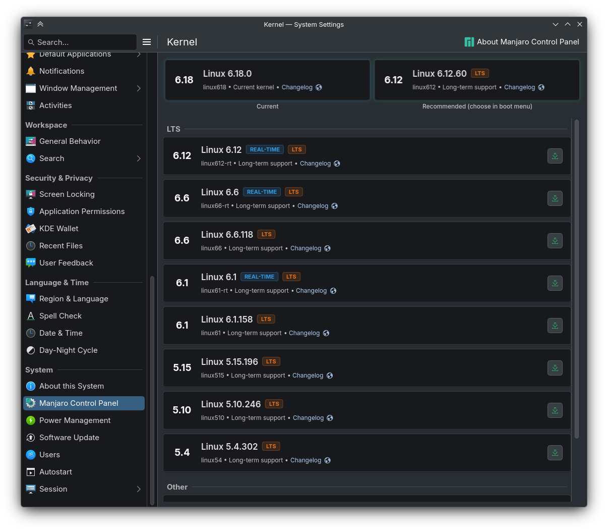

Ok it’s been a while… I was busy with a lot of things but finally I’ve found time and motivation to work on Manjaro Control Panel. I’ve fully reworked Kernels so far and started some groundwork for Drivers.
Currently supported features:
  • Unified backend for multiple UIs, based on libpamac
  • Qt/QML 6 modern UI (Kirigami)
  • KCM (Plasma’s System Settings page), based on Qt/QML UI
Features that are planned:
  • Command Line Interface – almost finished but needs a bit more work, will be ready in a couple of days I think.
  • GNOME UI – haven’t worked on that for now.
Features that would be nice to have:
  • Classic Qt-based UI for non-KDE users. I have a working concept but not sure I’ll have enough time to support it in any way.

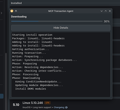

What’s next
Current scope of the tool is Kernels and Drivers only. I plan to go iteratively this time and the plan is:
  1. Test and roll out Kernels Qt and CLI
  2. Continue working on Drivers
  3. Test and roll out Drivers
  4. Start with GNOME UI

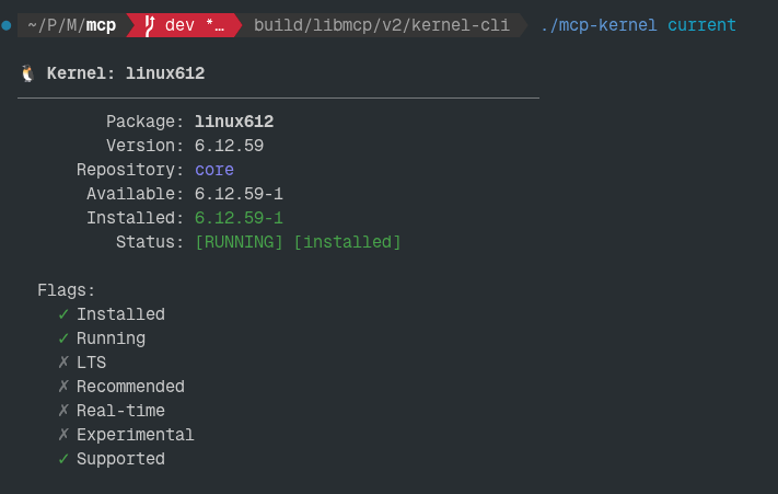

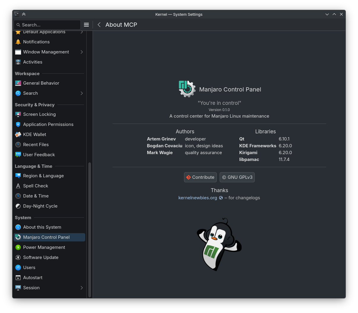

Screenshots:
Qt/QML/KCM
CLI
Known issues
  • Kernel list doesn’t update after installation
  • Installation status can show up out-of-order
  • Translations are missing
  • You tell me (better using issues page)
The repository is: GitHub - LordTermor/manjaro-control-panel: New Manjaro settings manager · GitHub
In packaging subfolder there is PKGBUILD. You can try building it yourself to test.

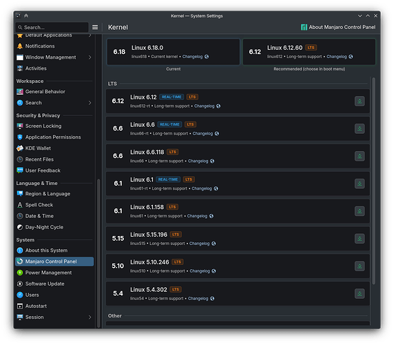

The cli looks nice. The gui does not have indicator for installed kernel (from the screenshot).
Other than that i fail to see how this will replace MSM if it does not support xfce and is missing half of the modules like the time for example. And you don’t even plan to do that.
As with all recent manjaro development, this is rising more questions than giving answers. Like are you, the manjaro developers, planning to officially drop support for xfce?
At the top of the image there’s kernel 6.18 showing as current.
It could probably be highlighted more somehow to make it obvious. Perhaps forcing a brighter border (green) to attract the eye. But, then again, I found it easily enough. :wink:
It does support XFCE, just like the previous one.
I’m open to adding some features specific to other DEs (as Plasma has time settings itself) especially more trivial ones. I just don’t want Plasma to have duplicates as we’ve got a talk with KDE devs about time in past.
We have dozen of devs who use different DEs. It just happened that I use Plasma and work with Plasma input data (design language, available settings). As far as I know nobody is planning to drop XFCE.

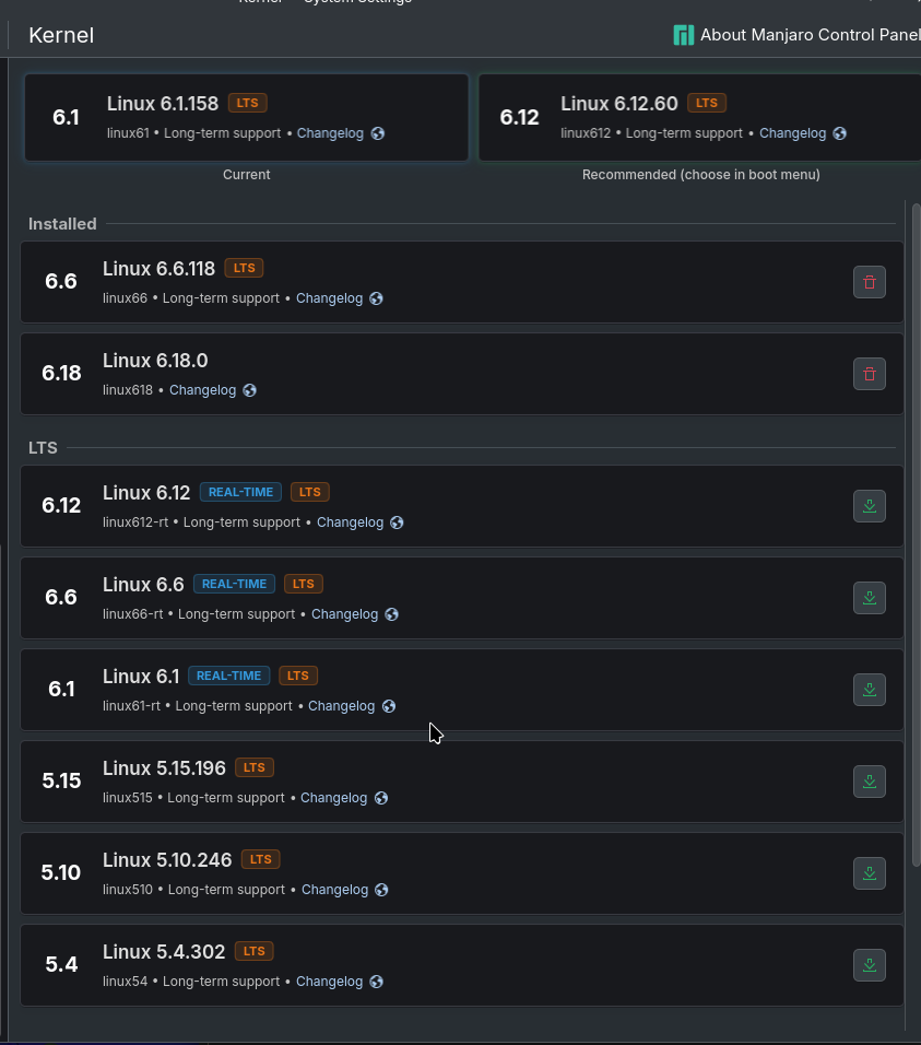

Maybe renaming to “currently installed” as i understood “current” as “latest”
It should be “currently in use” I guess…
Yes.
But still if you have many kernels installed it should als be indicated on the list.
It doesn’t show up in list at all now, only on top, to have it harder to mix up. Installed kernels have their own section.
  • Active or In use seems to be self-explanatory.
  • Installed for those kernels, err … installed.
  • something neutral (or no indicator) for other kernel options.
:man_shrugging:
