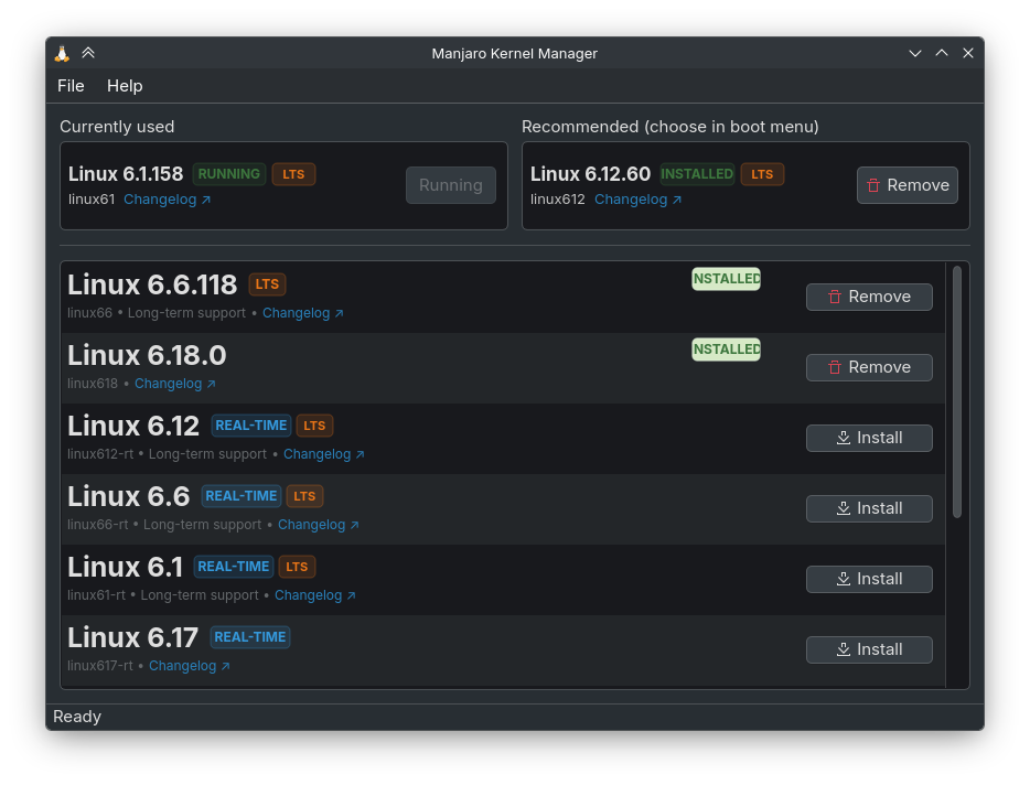

classic requires quite a bit of tweaking to make it releasable. I can share a screenshot though:
It’s QWidget based on mix of modern QML design and old kernels MSM page.
Currently we can not remove kernels, only installation seem possible.

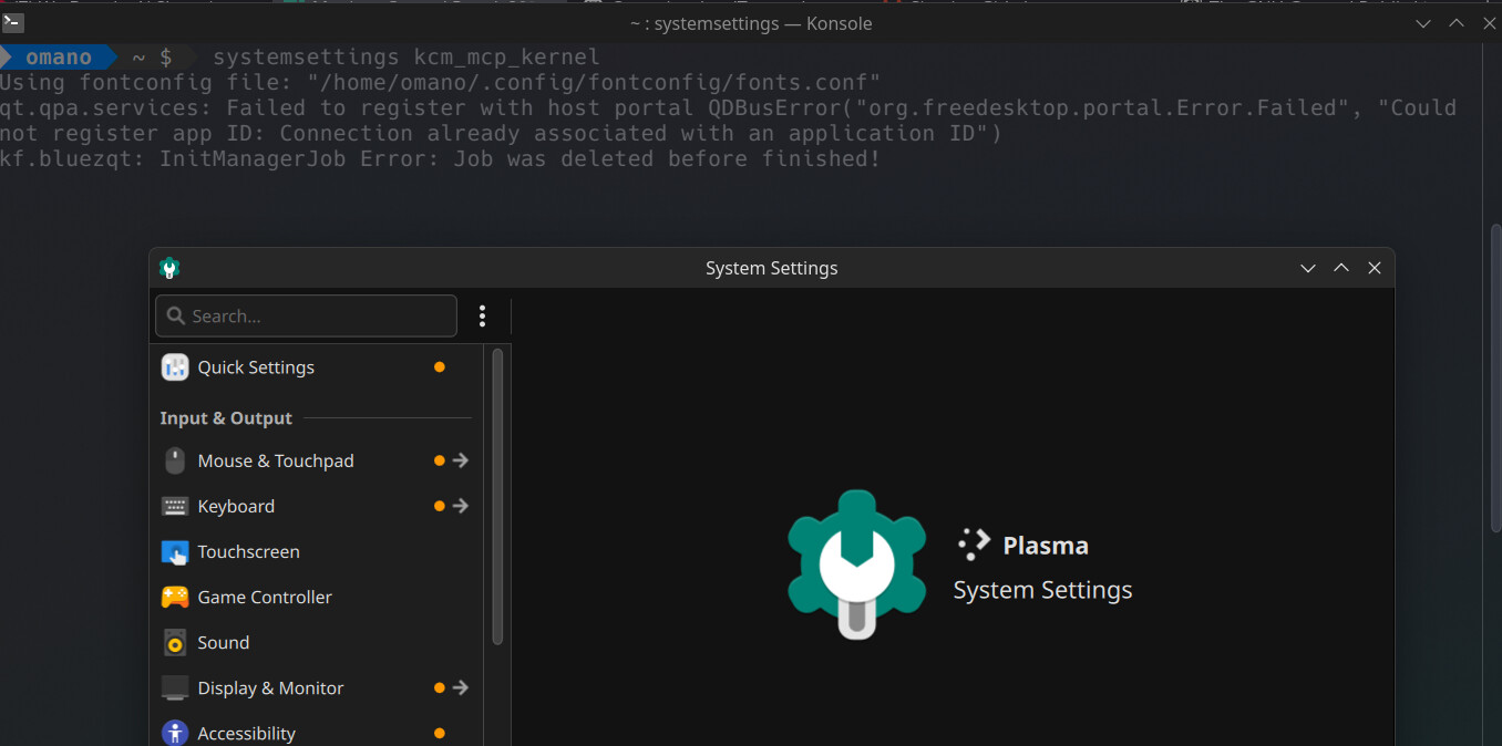

The KCM doesn’t work for me.
Can’t reproduce but I think I need to try on a fresh installation to see if I could with it… Thanks.
It worked until my last problem report. I am curious to see how things will develop in the future; perhaps there is a possibility of supplying it for all variants.
I think you just need to add mcp-qt as a dep for classic version and then it works. Not indended. I need to package something like libmcp-qt it seems

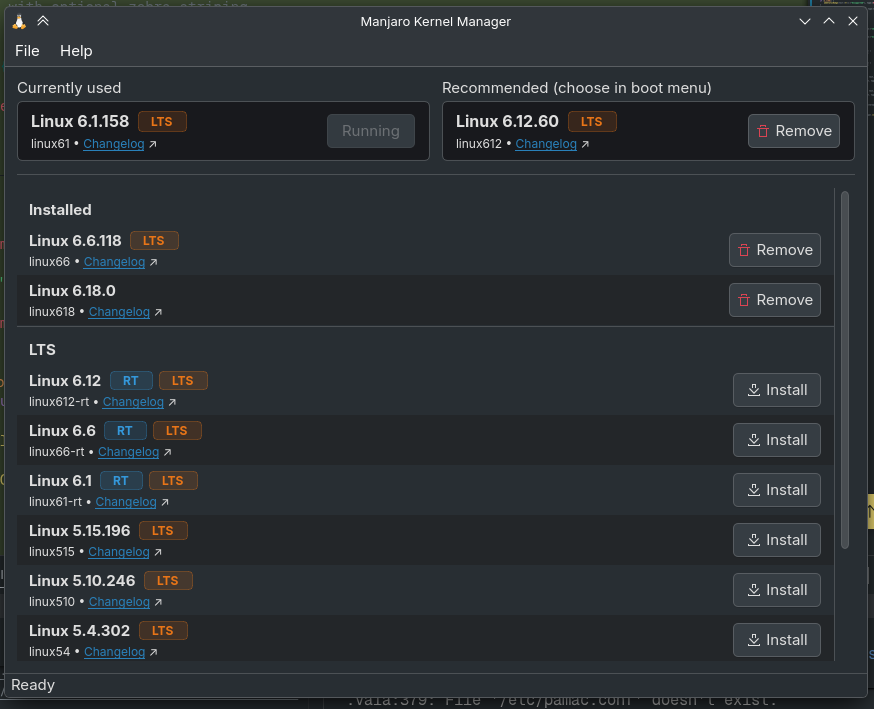

UPD: I came up with a bit better classic design. As I’ve seen it’s also pretty large user group so I need to focus on that too. Updated UI is in repo.

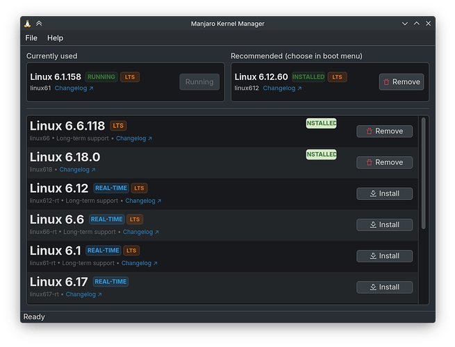

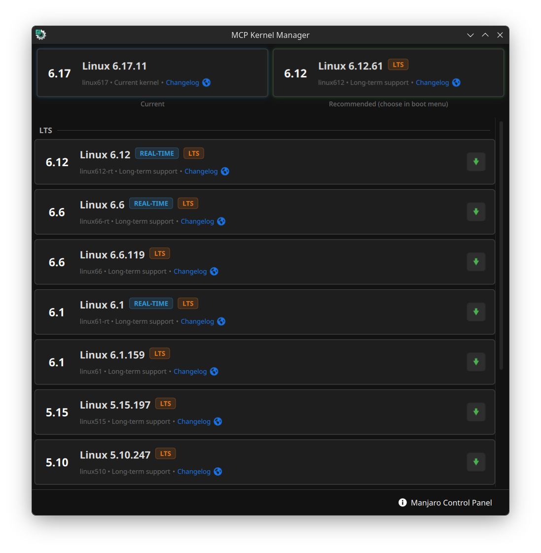

09.12.2025 Updated quite a bit of things:
  • New libmcp-qt for a shared qt logic/resources without kf6 dependencies (I hope)
  • Removed dependency of breeze theme for mcp-qt
  • KCM now should work fine
  • fixes here and there, updated appearance of mcp-classic for breeze theme
All PKGBUILD updates are in the repo.

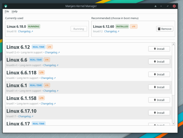

This looks really good for KDE Plasma, but what about the rest of the distros? I know @romangg was working on an update to the hardwareConfiguration dialog here: Are you using the Hardware Configuration Dialog? , well at least he was inquiring about it, did anything come of it?
I think @omano was trying to launch it inside systemsettings…
Try running mcp-qt-classic instead maybe…
Looks sweet here :wink: and no problem hitting the trash bin to remove the last kernel left from the last update.
nice UI
I like it a bit more than the one in post #8

Literally that, there is no possibility of removing kernels in MCP (not MCP Classic which is actually disabled in the PKGBUILD).
No the System Settings KCM is separate, and there is an issue loading it (it doesn’t even show in System Settings, I tried to launch it from terminal as the screenshot shows).
It isn’t built as it is disabled in the PKGBUILD.
The rest of DEs will get a QWidgets based UI resembling old MSM. Check screenshots.

Sorry I meant ones that can be removed.
Recommended and current can’t be removed. I can make recommended removable but not sure if it makes sense to allow that.
I think that would be OK to not allow the removal of currently used kernel, but I don’t understand why you would disallow to remove recommended kernel that makes no sense to me.
The KCM now works, but still the same regarding removal of kernels obviously as it is the intended logic for now.
