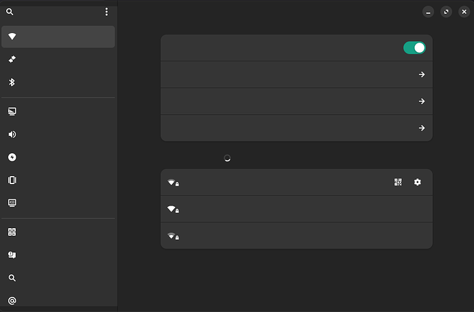

Manjaro 24 error display on setting and file after install Nvidia driver
error is:
and
So how i can fix it!

Answer what has been asked first.
Sorry!
Still not work!
Same problem here, the only solution I found was to remove the nvidia drivers, once done there were no more graphic errors. I think the problem is actually related to the nvidia drivers

Try to add
GSK_RENDERER=gl
in the etc/environment file.
For me it’was the solution .
This line allows you to use the old GL rendering engine which requires less GPU. I think the integration of the new engine is not yet correctly integrated into the nvidia video driver
