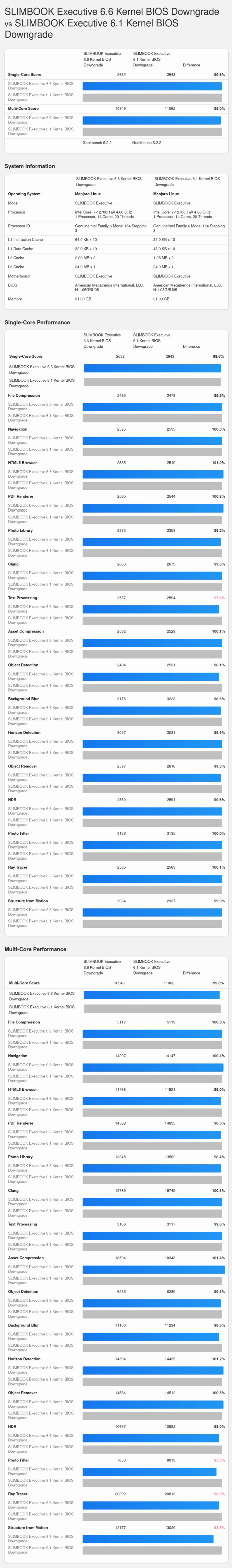

You have made a Geekbench benchmark and your single core performance on an i7-13700H on 6.6 LTS kernel is worse than my single code performance on an i7-12700H on 6.1 LTS kernel.
Don’t you think it is a regression?
